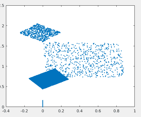

The code is as followed:
Matlab:
function fern()
AI = [0  0 ; 0 0.16];
AII = [ 0.85  0.04 ; -0.04 -0.85 ] ;
AIII = [ 0.2  -0.26 ; 0.23 0.22 ] ;
AIV = [-0.15  0.28 ; 0.26 0.24 ];BI = [ 0 ; 0];
BII = [ 0 ; 1.6];
BIII = [ 0 ; 1.6];
BIV = [0 ; 0.44];
N = 10000;
I = 50;
H = zeros(N,2);
for n=1 : N
    x = rand;
    y = rand;
    T = [x;y];
    for i=1 : I
        p = rand;
        if p < 0.01
            %disp('Scheme 1')
            S1x = AI*T + BI;
            S1y = AI*T + BI;
            x = S1x(1);
            y = S1y(2);
        elseif p < 0.08
            %disp('Scheme 2')
            S2x = AII*T + BII;
            S2y = AII*T + BII;
            x = S2x(1);
            y = S2y(2);
        elseif p < 0.15
            %disp('Scheme 3')
            S3x = AIII*T + BII;
            S3y = AIII*T + BII;
            x = S3x(1);
            y = S3y(2);
        else
            %disp('Scheme 4')
            S4x = AIV*T + BIV;
            S4y = AIV*T + BIV;
            x = S4x(1);
            y = S4y(2);
        end
        H(n,1) = x;
        H(n,2) = y;
    end
end
X = H(:,1);
Y = H(:,2);
plot(X,Y,'.')
I have no idea why it isn't working. Is not the iterative process correct? I ran it once and got the picture below. I'm at the end of the road here, and on a deadline, any help would be appreciated.
