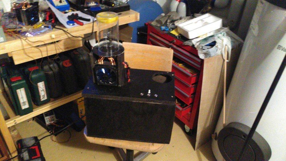

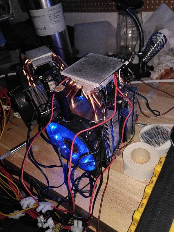

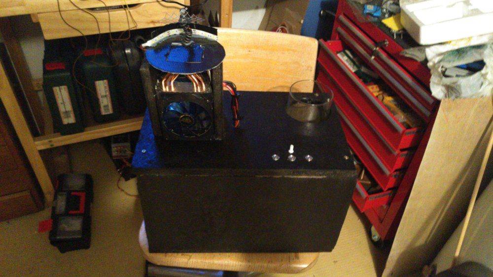

Hi,
For a few weeks I'm trying to build a Peltier based cloud chamber. I use a stack of 3 Peltier (from the bottom, a tec1-12710 12v, tec1-12710 5v, tec1-12709 5v and on top a 60mmx60x2.5 copper plate). I mesured -37° celcius on top of the last Peltier ans -27° on the copper plate. I also have an high tension module and use pure isopropanol.
On one of the first try I got beautiful tracks from natural radiation, but since I can't make it work again. I have a mist, but no tracks. I also tried running it outside, the plate was at -36°, I had a bigger mist but still no tracks.
Do you guys have an idea why it doesn't work ?
The only time the cloud chamber worked :

Nicube said:
Summary::. ...I have a mist, but no tracks. I also tried running it outside, the plate was at -36°, I had a bigger mist but still no tracks
The cloud chamber should be operated at 100% relative “humidity” rather than in a condition where a fog is present. Humidity here meaning isopropanol vapor. The fog chambers I have used were clear - not foggy. The speeding particle induces disturbances in its wake that allow the volatile component to condense into a fog. If the vapor has already condensed though...
A fix would be to decrease the temperature difference between the vapor source and the cold plate. Less power to the Peltiers?
Likes trurle
There are a few factors to consider, assuming you already have the low temperature needed:
- concentration of the alcohol should be as high as possible (min 91% but higher is better)
-temperature gradient - top of the chamber where is the alcohol evaporation taking place should be higher than the bottom (you can use some sort of heater)
- evaporator surface should be evenly situated above the active area - felt works best!
- use low angle bright, sharp (not diffused) light and darken the room. The kind o light that shows off dust particles in the air
- finally consider an "Ion scrubber" - this is a high-voltage field which cleans the ions from the camber and "resets" it.
Before building an actual one...just get an inflated balooon, rub it in some wool to pickup static electricity charge and place it on top of the chamber.
you can take a look at my Cloud Chamber build - blog.kotarak.net
Likes Spinnor
Had the same problem, poured much more Isopropanol 3-6ml - worked as a charm.
