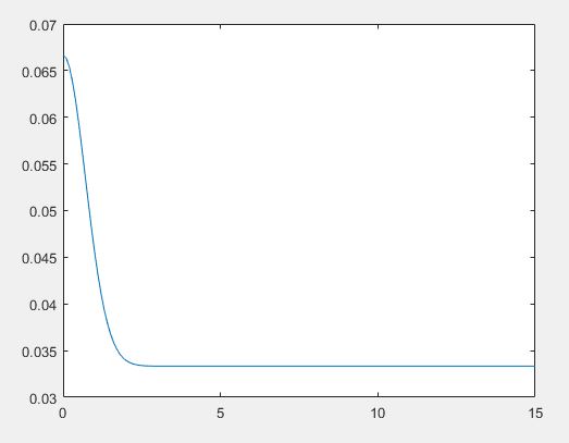

Write code for solving the integral ##\int_{0}^{x}e^{-t^2}dx## using simpsons method and then plot the function from ##x = 0## to ##x = 5## with ##0.1## increment.
3. The Attempt at a Solution [/B]
I was told that the best way to plot the function is to write it in Matlab so i decided to give it a go since i haven't really worked in MATLAB before.This is my integral solution code:

and the plot code:
Matlab:
x = 0:0.1:15;
y = simpson_method(x);
plot(x,y)
But the output plot is wrong and looks like this:
Which is weird since the function i wrote gives correct values at all points. What is wrong here?

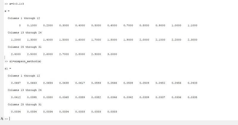

You might want to check whether or not your function gives the correct output when you feed it a vector of several points to evaluate it at.
I'm not sure how to do that on MATLAB just yet. Is there somewhere i can see examples of that?
That is what you are doing when you first write x = 0:9.1:15 and then function(x). You are passing a vector as argument and your function needs to be able to handle that.
It does output wrong when i input a vector. How do i fix that in the code? How to make a function able to handle a vector?
You should take a close look at your function. Notice that y1 is always 1. Is that what you want in the last equation for y? I recommend that you simplify the function, add comments to keep it clear, and do not use the variable y inside the loop.

diredragon said:
for i = 1 : (x - 0)/h - 0.5 %summing the parts of the function
What do you think this line does?
Edit: I also strongly advice against using i as a variable. It should be reserved for the imaginary unit.
This line is a for loop which increases i from 1 to x/n which is a number of sub-intervals. The -0.5 was added as it does not output correct when i simply write x/n
But the x you input is a vector!
Likes diredragon
Oh i see it now, can't use x. Does it also pose a problem in the definition of yn? Also do i now need somehow to state that only one element at a time from x is used in the loop. How do i do that?
