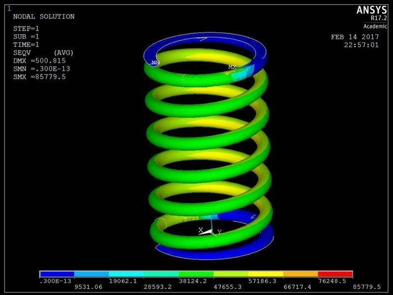

Hi,
could you help me with my parametric model please? I have a problem with the end of spring. At the end of load (displacement) is problem with solve stress because there is concentrated stress and it shouldn't be. I didn't define contact between coils yet. I need to repair this fail at first. So if you could help me with to solve this problem it will be fine.
Here is the code of the spring:

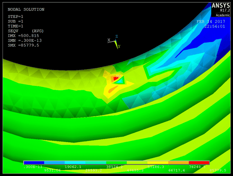

It looks as though the geometry you have specified has a single point in the mesh near your boundary condition, which is in turn causing a stress discontinuity. I recommend re-visiting your mesh geometry or geometry creation to make sure you don't have any sharp corners or points, but even in that case if you're applying a fixed deformation at that surface your maximum stress will probably continue to show up in that region near the boundary condition.

I tried to set a finer mesh but the maximum of nodes which I can use is only 32 000 because I have only student licence. I worked only with beams yet so I'm little bit confused. It's my first solid model which I need to my bachelor thesis. I tried to apply without fixed deformation a pressure but the solution was same. Someone said me that I should to turn on a midside nodes but when I tried it so I get only error. Is there any other way to define compression of spring? I know a lengths of spring like L0, L1, L8 and L9 so I need to define compression.

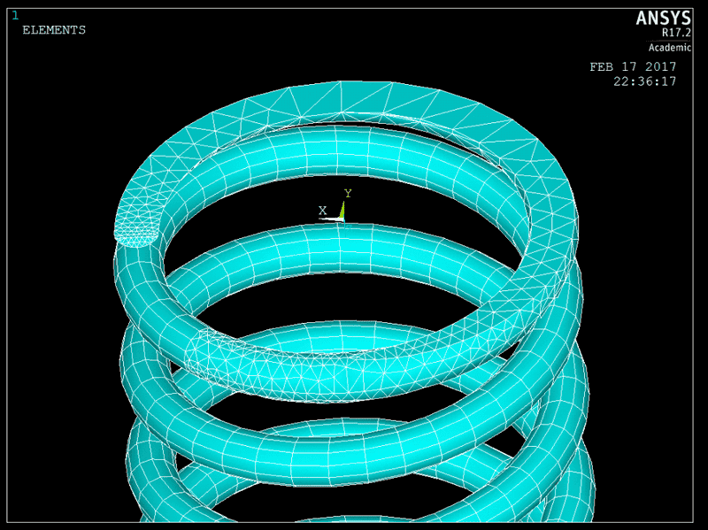

Yes, I understand. But in my opinion in this area shouldn!t be stress concrentrations. For sweep I used solid 186 and last coil is meshed with solid187. I tried to mesh with mesh200 but it's not possible.
Yes, I have. The sweep mesh is only on the portion of the spring which has a constant cross-section. Only the coil which have not a constant cross-section is meshed by free mesh.
This is my mesh.
Nice work. What kind of boundary conditions are you applying to the spring to compress it?
On one side I set all DOFS as zero and on second side I defined only uz. I can't apply pressure because I don't know but displacement I know.
Your stress concentration in your mesh is expected, as it is a result of the flat grind on the end of the spring. Because the DOF's are set to zero at all nodes on that surface, the flexible element nearest the flat surface sees an abnormal amount of stress; in essence, it's like being welded to another infinitely rigid surface. A few options to reduce or eliminate this stress are:
  1. Get rid of the flat ground surfaces, constrain at the wire ends instead
  2. Use a flexible body to compress the spring with potentially non-linear boundary conditions
  3. Utilize a "compression only" support at the flat surfaces and then separately constrain rigid body motion using nodal supports at a few key vertices
No amount of mesh optimization will completely eliminate this stress concentration, only increase the precision at which you're calculating the stress there. Does this make sense?
