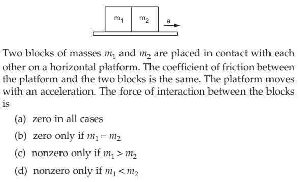

Hello, everyone.
This problem is easy if you assume that the friction between the blocks and the platform is the maximum possible. Then the normal force is 0. But how can you show that the normal is 0 even when the friction is less than maximum?
Thank you for your help.

Do you mean: the force of interaction between the blocks ?
What about the acceleration of each of the blocks when the friction between the blocks and the platform is less than maximum ?

Yes, the force of interaction between the blocks, or the normal force between them (i.e. the contact force that is perpendicular to the surface of the blocks).
"What about the acceleration of each of the blocks when the friction between the blocks and the platform is less than maximum ?"
That is the question I can't answer yet. I guess is still 0, but I don't know how to prove it.
"This happens when the blocks are at the point of sliding, and beyond that point as well, right ?"
Yes, that is correct, because this is the equation of the normal force that mass 2 exerted over mass 1:
So, if Fr1km1g and if Fr2km2g then the normal is 0.##\ ##
In that case none of the blocks is sliding. So their acceleration is exactly equal, and the friction force alone (between blocks and platform) is causing that acceleration. Meaning the net force is the frinction force, ergo the contact force must be zero !

That can be deduced from Newton's laws of motion like this:
Taking the masses as a whole, this is the Newton's second law for the system:
$$(m_1+m_2)a=Fr_1 + Fr_2$$
(With ##Fr_1## and ##Fr_2## the respectively friction forces)
Which implies:
$$a=\frac{Fr_1+Fr_2}{m_1+m_2}$$
Newton's second law for the For the ##m_1##
$$m_1a=Fr_1 -N_{21}$$
Then:
$$N_{21}=Fr_1 -m_1a$$
Replacing ##a##, and cancelling similar terms you'll get to:
$$N_{21}=\frac{m_2Fr_1-m_1Fr_2}{m_1+m_2}$$
it is a statically indeterminate problem even for a=0

The question is whether you could have a force between the blocks. And the answer must be yes. A very large coefficient of friction would mean that the blocks are effectively stuck to the surface. It would, therefore, take significant force between them to push them apart (even if the whole system has some horizontal acceleration).

Not friction between the blocks. There could be any force between the blocks. They could, say, be charged and be electromagnetically repelling each other. They could also be attracting each other.
There could be a small compressed spring between them, trying to force them apart.
As @wrobel says, this makes the problem statically indeterminate. You may add internal forces to the system that do not result in motion.

This makes no sense. There could be a force, so you cannor prove there is not. If you assume there is no contact force, then that isn't a proof.
Astr said:
I can prove that this normal is 0 if friction is proportional to the mass.
If you really could prove that, you could also prove there are no horizontal intermolecular forces within the blocks.

This assertion is false.
Take, for instance the situation where I am standing in the bed of a pickup truck that is slowly accelerating from a stop. I am facing forward, pushing on a heavy box that is also sitting in the bed.
My shoes are not sliding on the bed. The box is not sliding on the bed. Yet there is a force between us. The situation is statically indeterminate.

The available answers are all wrong. The answer is indeterminate. It's not that complicated, as the static examples show. It's more a fundamental lack of knowledge on the part of the question setter. Or, just an oversight.
If the question was whether the accelerated motion requires a force between the blocks, then the answer is no.
