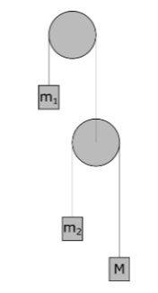

I cant figure out how to solve this task. I have got two pulleys, top pulley (A) and bottom pulley(B).
The pulley (A) is stuck to the wall and cannot move. The pulley B hangs in a thread and can
therefore moveup and down. Here m1 = 0.5 kg and m2 = 2.0 kg. Both pulleys can rotate freely. All
the pulleys can be are massless and there is no friction in the system.
How large must M be for m1 to be at rest?
Look at the figure.
Thanks for help!
T1 - m1g = ma, where a = 0
I know that the tension from pulley B (T1) has to be equal the m*g of m1 for m1 to have acceleration = 0. But i can't figure how this works because the m2 is already heavier. And so the block(M) has to be negative weight?
Heres the figure:

If M is zero which direction will m1 move? The problem is not a statics problem.
If M is zero, and also the pulley(b) is massless. Then the only thing weighing on the right side would be m2 that is 2kg. So the m1 that is 0.5kg would move upwards right?
What would (M=0) be the tension in the string if the pulleys are ideal and massless?
Are you thinking of the tension on the string T1 (on m1 from pulley B) or the tension on the string T2 (on M from m2) For in both cases i would say it is (T = m2g = 2*9.81 = 19.64N)
If M=0 then m1 will be accelerating down at g (there will be no constraint or T). If M is large then m1 will be accelerating up. Clearly somewhere in between m1 will have a=0
Draw a free body diagram for each mass and Newton for each . Put in the constraints from the pulley. Set a=0 for m1 (but not m2 m3)

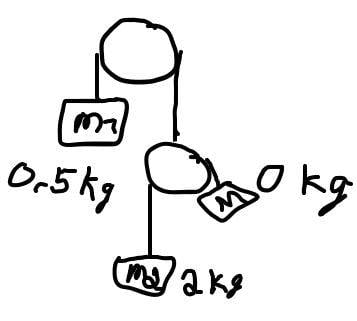

I drawed a new figure if M was to be 0 in this situation. But so what your conclusion is that fr m1 to stay at rest. In this situation M has to be 0 then?

Newton for m2: 19.62N
Newton for M (if M is 0kg): 0
No that is not what I said. Reread#7
My apologies for my shorthand I meant write down Newton's Law for m2 and M
So Newtons 2.law is F = ma
Where F will be T - mg, so it is T - mg = ma
But since M is zero, the tension will be 0
So it is -mg = ma
For M that is ofcourse 0, but i don't understand m2
-m2*g = mM*a => -m2*g = 0, so the tension here will also be 0?

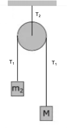

For whatever it's worth, here is a different approach.
  1. Assume that the pulley on the right is attached to the ceiling. Find the tension in the string connecting it to the ceiling as a function of , and .
  2. Answer the question, "if is at rest, what must the tension be in the string attached to it?"
  3. Set and solve for .

It is correct to say that . You missed my point for the rest of what you have to do. The picture below shows a massless pulley attached to the ceiling and two unequal masses and . The first step is to find an expression for tension in terms of and . The second step is to set the expression equal to and solve for .
On Edit:
Tension mentioned above is the tension in the piece of the rope that is attached to mass as defined in item 2, post #19. It is not tension shown in the figure above. I am sorry for the unfortunate choice of subscripts and the confusion it might cause.
Likes scottdave and erobz

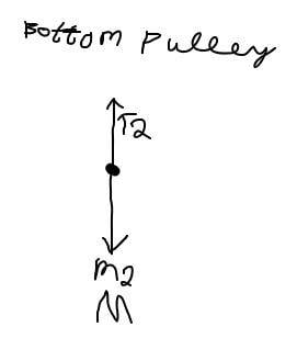

Slow down. You need some more things here. Do a FBD of the lower pulley. What are the forces acting on it? Remember you are isolating the pulley when you do this.
  • #32
The force acting on it will be T2 upward and m2 and M downwards

or aren't forces. You are to be "freeing" the pulley from all other bodies, severing the ropes. What are the forces acting to pull the pulley down. What is the force acting to pull the pulley upward? Are these forces balanced on the pulley?
  • #34
If that's the case, forces acting on it downwards is the gravitational force. BUT i don't understand what you mean with the upward force. Because you said to isolate the pulley, but you agreed that it wasnt accelerating (vertically at least) so the upward force is the same as downward force then? which is the gravitatioal force ??
  • #35
We are freeing the pulley from the other bodies. Not from the forces. What are the internal forces inside the rope that we expose when we "free" the pulley.
