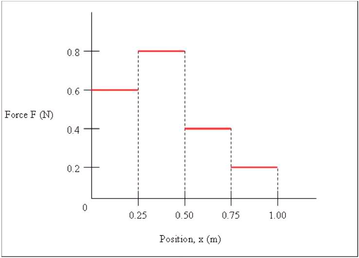

An object is acted on by the force shown below. What is the final position of the object if
its initial position is x = 0.40m and the work done on it is equal to
(a) 0.21 J
(b) (b) -0.19 J.
W = F1x1 + F2(x2 - x1)
a) W= F(x2-x1) = 0.8N* (x2- 0.40m)
but i DON'T get the answer correctly.
How do you determine the work done from the graph you have given? Does that correspond to the formula you gave?

Hi lucky_star! Welcome to PF! :smile:
Why have you used only one value of F?
F has different values as x changes.
Oh, I made a mistake there. if initial position is 0.40m, the force is 0.8N. I am given W= 0.21J, So I will have:
0.21J= 0.8N*0.40m + 0.8N*(x2 - 0.40m)
0.21J= 0.8x2 - 0.32
x2= 0.66m
That's all I have. However, the correct answer that I have been provided is 0.90m. I really don't know how to solve this problem. Please give a hint!

Noooo … :cry:
Look at the graph!
The force is 0.8N only for x ≤ 0.50m.
Try again. :smile:

AHHH! I Think I understand the problem.
W= 0.8N *(0.5m-0.4m) + 0.4N *(0.75m-0.5m) + 0.2 *(x2-0.75m)
0.21J = 0.080+ 0.1 + 0.2x2
0.18 = 0.2x2
x2 = 0.90m
:biggrin: Woohoo! :biggrin:
Have a free quark! o:)
(and now try b … :wink:)
