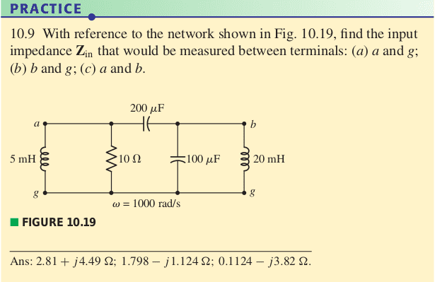

1. Homework Statement
the problem is my answer for question (a) is not the same as the answer provided by the question, i get 2.81 - j4.49 Ω while the answer demands 2.81 + j4.49 Ω
simplifying the circuit, details can be seen below
XL1=jωL1=j*20e-3*1000=j20Ω
XL2=jωL2=j*5e-3*1000=j5Ω
XC1=1/(-jωC1)=1/(j*100e-6*1000)=-j10Ω
XC2=1/(-jωC2)=1/(j*200e-6*1000)=-j5Ω
solving Zpar1:
Zpar1 = XL1 * XC1 /(XL1 + XC1)
Zpar1 = -j10Ω * j20Ω /(-j10Ω + j20Ω) = -j20Ω
solving Zser1:
Zser1 = -j20Ω - j5Ω = -j25Ω
solving Zin:
Zin = 1/((1/10)+(1/(j5))-(1/(j25))) = 2.81 - j4.49 Ω

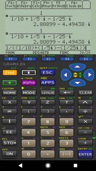

gneill said:
I believe that you are making some arithmetical mistake in evaluating the above expression. When I type the same thing into Mathcad I see:
i don't know if mathcad can give result like that because i calculated using ti-89 emulator and got result like what i posted above... you can see the screenshot on my attachmet
does the use of i or j symbol affect the calculation?
What you've just shown me is :
Not the same.
No.
Not the same.
ok i think i have the solution... i did not input the equation into my calculator properly, i have achieved the same result after adding more bracket symbol into my equation... thanks for the guidance

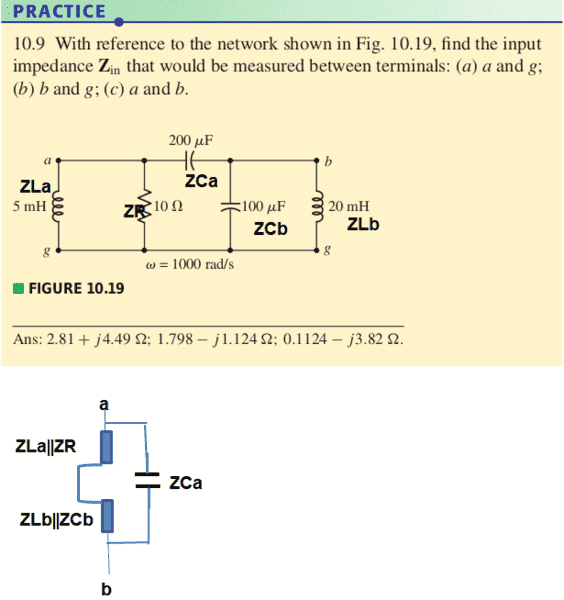

The answers provided for questions (a) and (b) in problem 10.9 are easily arrived at, however the answer given for question (c) doesn't make sense to me. Can someone clarify?
The part (c) result matches what I came up with.
You have a delta configuration to start, with the capacitance from a to b across the top.
The left leg of the delta is an L-R combination. The right leg is an L-C combo.
For the L-R combo, I got a value of 2 + j4. For the L-C combo, I got a value of -j20.
Keep in mind that the L-R part and the L-C part are in series with each other and this series (L-R + L-C) is in parallel with the capacitance.
As I said, the results agree with what is shown for part (c).
Likes berkeman
I confirm the answer for (c). I took the 10Ω resistor in parallel with the j5Ω inductor as Zleft. Then took -j10Ω cap in parallel with the j20Ω inductor as Zright.
Then Zleft in series with Zright.
Then that result in parallel with the -j5Ω cap.
Likes berkeman

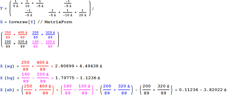

All the required impedances can be obtained in one go using a little linear algebra. Choose the bottom node (g) of the circuit to be the reference node. Label the other two nodes 1 and 2.
Write the admittance matrix (Y) by inspection.
Invert the Y matrix to obtain the impedance (Z) matrix. Two of the elements of the Z matrix are directly the impedances Z(ag) (shown in red) and Z(bg) (shown in magenta). The impedance Z(ab) is the sum of Z(ag) and Z(bg) minus the two transfer impedances:

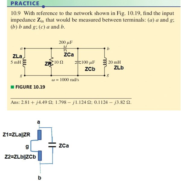

By the way, it is easier-in my opinion-to use Excel complex:
Define Name:
ZR=COMPLEX(10,0)
ZLa=COMPLEX(0,5)
ZLb=COMPLEX(0,20)
ZCa=COMPLEX(0,-5)
ZCb=COMPLEX(0,-10)
Z1=ZLa*ZR/(ZLa+ZR)=IMDIV(IMPRODUCT(ZLa,ZR),IMSUM(ZLa,ZR))
Z2=ZLb*ZCb/(ZLb+ZCb)=IMDIV(IMPRODUCT(ZLb,ZCb),IMSUM(ZLb,ZCb))
ZA=IMSUM(Z1,Z2); ZB=IMSUM(Z2,ZCa);ZC=IMSUM(Z1,ZCa)
Zab=ZA*ZCa/(ZA+ZCa)=IMDIV(IMPRODUCT(ZCa,ZA),IMSUM(ZCa,ZA))
Zag=Z1*ZB/(Z1+ZB)=IMDIV(IMPRODUCT(Z1,ZB),IMSUM(Z1,ZB)
Zbg=Z2*ZC/(ZC+Z2)=IMDIV(IMPRODUCT(Z2,ZC),IMSUM(Z2,ZC))
