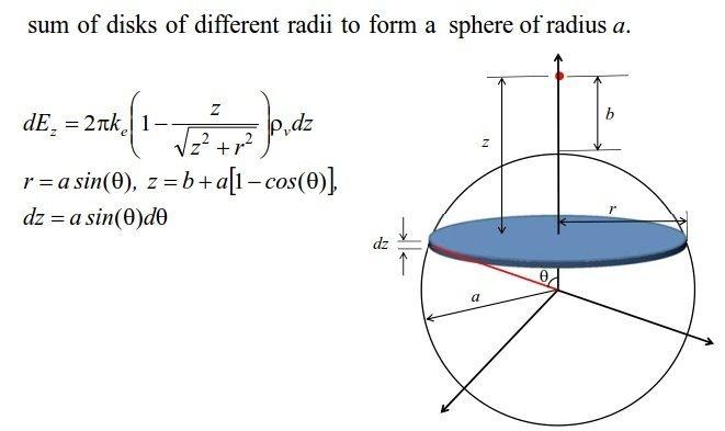

dE = ke(dq/r2)
How to change to complicated equation in the following picture?
mysci said:
σ=Q/ πR2 and
ρ=Q/ V
Then ρ=Q/ (πR2 x dz) in here?
Looks right.
haruspex said:
Looks right.
In fact, I don't understand although I can deduce it.
The volume of sphere is (4/3)πR3, (πR2 x dz) = base area x height = volume of cylinder
Whether I got wrong about the picture is talking about the cylinder not sphere?
Thanks.
Thanks.
dz indicates an arbitrarily thin slice. Such a thin slice of a sphere is effectively a very short cylinder. This is the basis of calculus.
