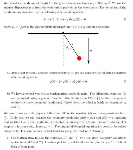

unfortunately, I have problems that Mathematica does not solve the differential equation. The task is as follows and it is about the task c
In the Mathematica Notebook, the following was written for task c
"You can use the following two lines of code to produce the solutions of the exact and approximated differential equations with boundary conditions. After that, write a plot[ ] function to sketch the two together."

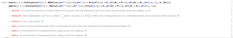

exact[t_] := Evaluate[phi[t] /. NDSolve[..., phi[t], {t, 0, 20}]];
approx[t_] := Evaluate[phi[t] /. DSolve[..., phi[t], t]];I then tried to calculate the differential equation for equation (4) using the two codes and got the following

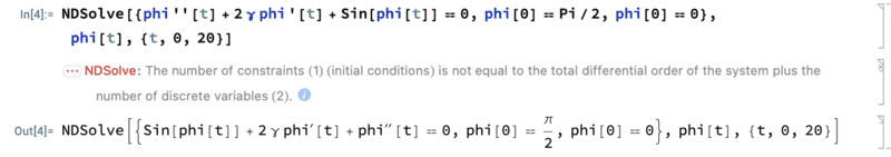

I then tried solving the differential equation using only NDSolve and get the following.
I am a beginner in Mathematica, so I do not know what I have done wrong in the two formulas?
As the error messages say, your initial conditions are wrong. You have
Code:
phi[0]==0
and
Code:
phi[0]==Pi/2
which is not meaningful. You should have the first derivative of phi for one of those.

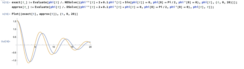

I have now tried plotting the differential equations again, but this time with phi'[0]=0 and with ##\gamma=0.1## and got the following.
Is there any way that I can show in the plot which function is which?
There are different options. Try for instance
Code:
Plot[{exact[t],approx[t]},{t,0,20},PlotLegends->"Expressions"]
Thanks DrClaude for your help, this is exactly what I was looking for 👍
