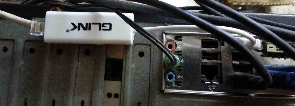

Can I try anything with the USB adapter to get it working again?
Yup, try putting it in a freezer for a half hour.
That description sounds like the "switch" is a "splitter." Two different things.
Any chance you can post a close-up photo of the "switch"? Also of the USB LAN Adapter?
Next time it fails, see if plugging into a different network cable in your house has any results.
If it uses a full-size USB connector that has been repeatedly plugged/unplugged, the connector could be a worn out. The usual ones are rated for 1500 plug/unplug cycles. Or the LAN connector could be worn out, or dirty.
In any case, so far my impression is the same as yours; it's the USB-LAN Adapter; but the cables are not above suspicion.
This one seems to be new. I don't, however, know about the condition of the circuit inside that white box shown above.

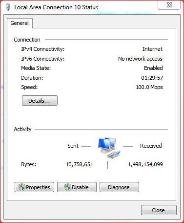

Quite possible, but I can't complain because my plan entitles me to 100 Mbps speed, and they are giving it to me:
Negative, that window you have pasted just shows the maximum possible communication speed between yourself and the switch you are connected to. That switch might have 1Mbps connection to the internet or a 1Gbps connection to the internet and it would still read the same thing, that's not your "internet" speed.

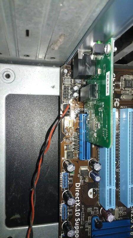

I bought a TP-LINK TG-3468 Gigabit PCIe Network Adapter from Amazon India. It requires a x1 PCIe slot, and our motherboard has a x4 slot, so it could fit in properly:
Once the ISP authorized the new MAC address, I did a speed test using Ookla, and got a ~ 50 Mbps download and upload speed. The results can be viewed here. Not the promised 100 Mbps, but definitely much better than ~ 6 Mbps that it was showing previously. This implies that the previous USB LAN adapter was problematic.
Till now, the internet has been working fine. No more sudden disruptions. Today I created a WiFi hotspot on the PC and connected my laptop to it. ~3 GB MATLAB download was completed in around two minutes. I used it for five hours total, and the connection was stable while I attended a two-hour webinar, so I can say that I am fairly satisfied with the new adapter.
