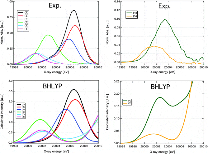

So I'm just starting a course and trying to learn reproducing stuff already done, here for example the have some exp. data and did some tddft calculations, what given values for the energy that requiered to be shifted.
Fig. 5 Experimental (top) and calculated (bottom) Mo K-pre-edge of the various compounds investigated in this study. For clarity, the plots show the measured HERFD-XAS spectra subtracted from all the contributions except the pre-edge features (derived from the fits). The calculations used the BHLYP functional with DKH2 relativity correction. A constant shift of 60.9 eV and a broadening of 3.5 eV were applied to all calculated spectra. The calculations using other functionals produce similar results.
So this constant shift of 60.9 , I don't know how they determine that value :(

Density functional theory gives some values that are very good, while others are known to have a consistent systematic bias. In my area of research, DFT gives vibrational frequencies of molecules that are all skewed in a single direction. When looking for a molecule's spectrum, you often apply a "fudge factor" to the DFT numbers to get a ball-park estimate of what the actual values should be. It sounds like the 60.9 eV shift to the DFT values above might be something along these lines. The particular value might be picked to simply line things up, or it may be based upon a known systematic problem with calculating the spectra in this region with this flavor of DFT.

I don't think that this is a calculated number. It is either a value that is obtained from comparing the experiment and theory and coming up with a shift to bring things into agreement (basically shifting the axis horizontally to get the broad peaks to match up). Or, it could be a number that is tabulated somwhere for practitioners to use when comparing Mo K-edge spectra with DFT theory. Read the section of the paper a bit more carefully where they discuss the results. If it is the latter, they will give a reference, if it is the former, they may say how they determined the best number for the shift and the width parameters (i.e. least squares fit to the experimental data, by eyeball, etc.)
