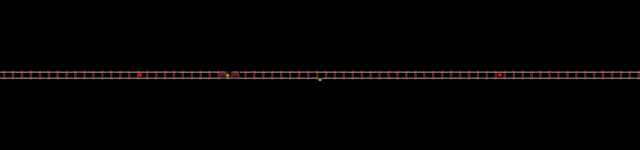

This might help. It similar to the train experiment above, except we have arranged things so the light flashes
arrive at the same time as the observers pass each other. Thus both observers see the both flashes at the same time.
Here we have the events in the embankment frame:
The light flashes ( expanding circles) leave the emission point simultaneously, expand outward at c and arrive at the observers just as they meet.

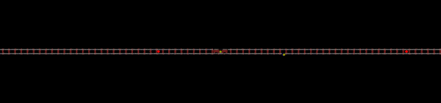

If we switch to the railway car frame:
The light flashes again expand outward at c equally in all directions, but relative to the railway car. The red dots do not stay in the centers of the expanding centers, but move off to the left.
The flashes still arrive at both observers as they pass each other. However, since both flashes have to originate before the observers meet and the train observer is halfway between the dots, The observer has to be closer to the left dot then he is the right dot when either flash is first emitted. Thus the only way for the flash from the right dot to arrive at both observers at the same time as the flash from the left dot, is for it to have left first. Thus according to the train observer, the light flashes could not originated at the same time.

Janus said:
If you look at things from the Embankment frame, it is obvious that the light from B strikes the train observer first according in this frame. This is a key point, as the Embankment observer and train observer cannot disagree on this fact. ( allowing this to happen would also allow for the creation of physical contradictions. Thus, from in the Train's frame, you have to start from the fact that he doesn't see the flashes at the same time, and being halfway between the emission points (ends of the Train) the travel time for these falshes must be equal and ergo, according to the Train observer, the lightning strikes were not simultaneous.The difference here is that with the cannon balls, our train observer could measure a difference in the speeds of the balls relative to the train and himself. When he takes this into account, he would conclude that both cannons were fired simulataneously, even though the balls reached him at different times as one ball was in flight for a longer time. This is different than the light example, where the flashes arrived at different times, but spent equal times "in flight".
With the light example, each observer measures the light as moving at c relative to himself and at v +/-c relative to the other observer, while with the Newtonian cannonball example, both observers agree on how fast the cannonballs are moving with respect to either observer.
very nice animations, this works better than the text too, thank you
