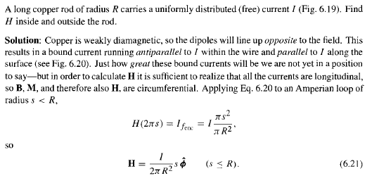

im having problems with fields inside matter. i get the left side of gaussian surfaces/ampere loops. but for example this first equation's right side i can't understand.
i would think the right side should be
[itex]I[/itex]
since its the total enclosed current by my ampere loop
but the book says
[itex]I\frac{\pi s^2}{\pi R^2}[/itex]
it has something to do with the dependence of the current enclosed and the distance, which you don't have outside the cylinder. but i can't figure it out. can someone explain?

It says [itex]s\leq R[/itex]. The loop that you draw is inside the wire, so you get a fraction of the total current. That fraction being the fraction of area of your loop compared to the total area of the wire. Outside the wire, you would just set [itex]s=R[/itex] and get back the total current you were talking about.
