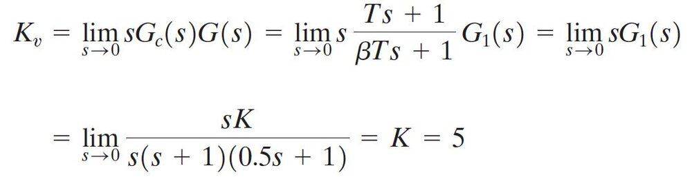

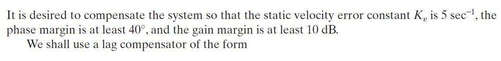

Hello Community,
for a School Projekt I must design a lag compensator according to Ogata. Unfortenutely I have some Problems. At first I must find a Value for Kv. I don't know why he use for Kv 5 1/sec in this example. He don't explain why he use 5 and why he use at least 40 degrees.
In the next step he calculate K with lim in this example.
How can i Use this Method for my open-loop transfer function and how can I determine that?
Thank you for ur answers
