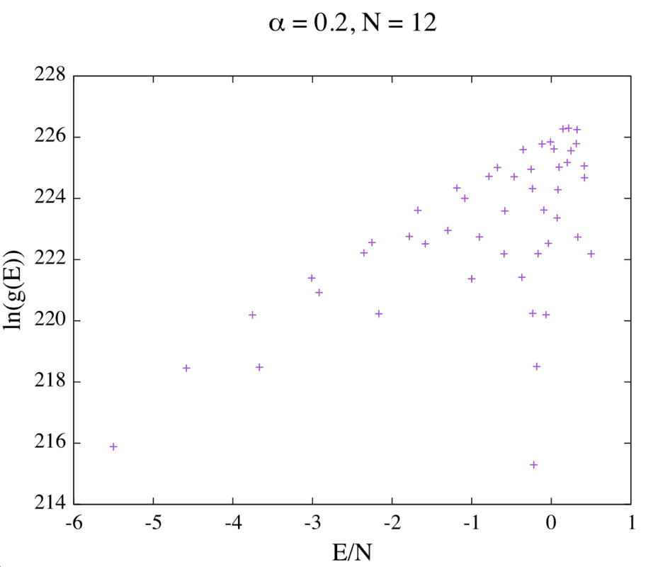

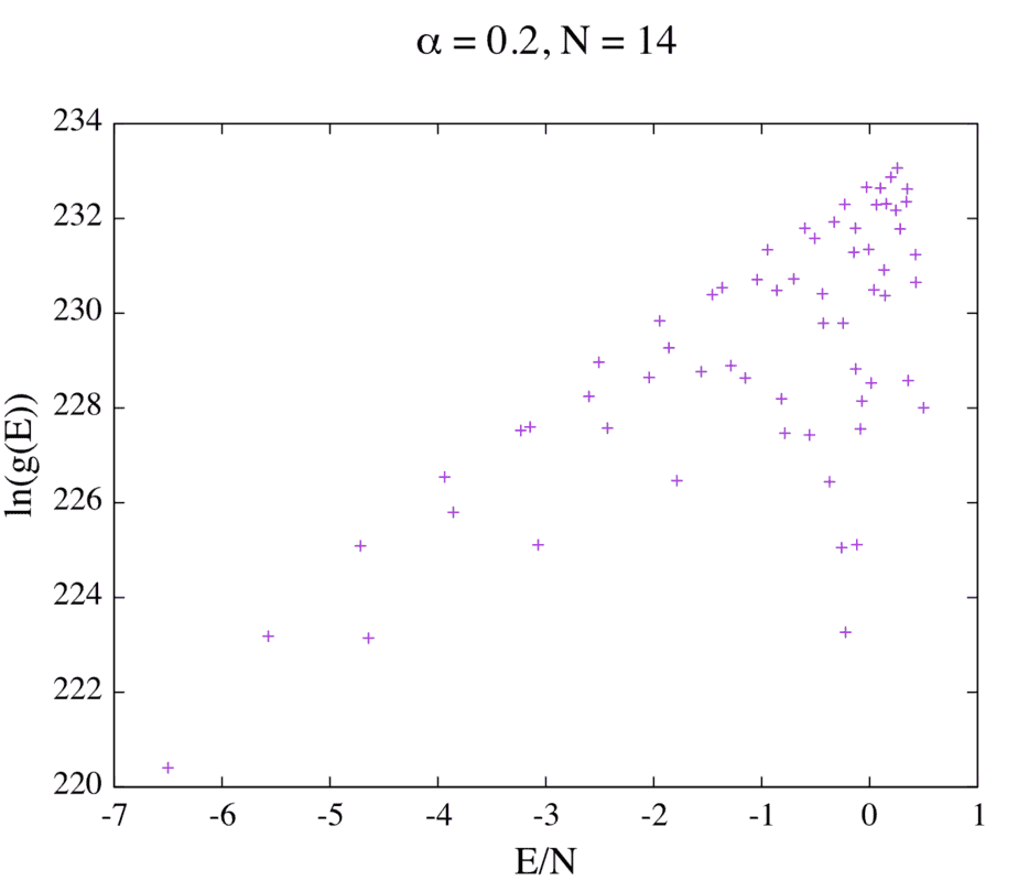

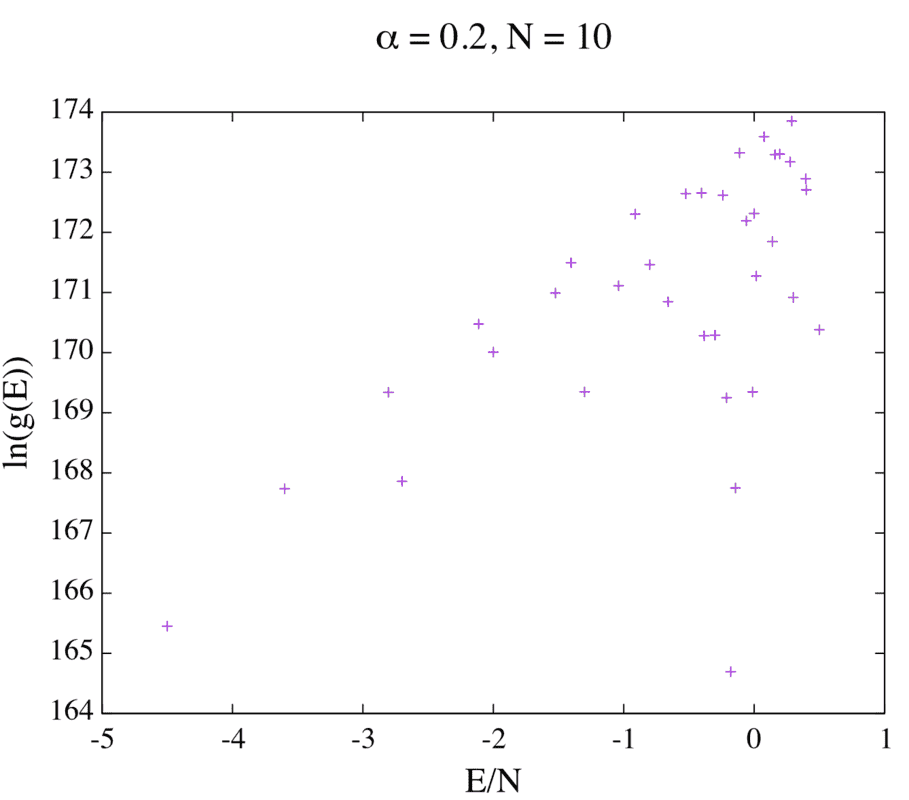

I am determining a first order transition using the wang-landau algorithm but I have problems with the implementation. I get unvisited configurations, so the histogram never becomes flat.
I am trying with an arbitrary value of alpha = 0.2
It seems to work for N <= 14 (I attach figures of the unnormalised logarithm of the density states array versus energy) but I doesn't work for bigger systems.

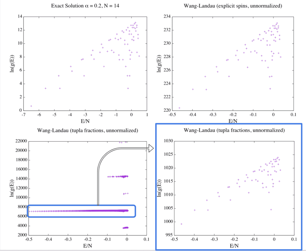

5. This was also suggested by my professor so I ended up doing it. The second code is now visible in the github repository (https://github.com/IreneFerri/alpha3states.git) . It achieves flat histograms for any size N, however the results are wrong. I attach here a comparison of the output of my 3 programs: the exact calculation in python, the first Wang-Landau code we already spoke about, and the new program which uses the tuple (n1, n0, n_1) instead of the explicit spins array. The problem is described in detail in Github>issues, but it is easy to see that the results of the first code did match the exact solution, so maybe the problem for larger N was related to the rounding errors, as you suggested in the comment 6. This is not a problem anymore since I can find the index with an exact function.
6. Already explained in 5.
So, basically now I have the old code, which I know it works for N=14 but cannot perform calculations for bigger sizes, and a second code that achieve flat histograms for any size but delivers crazy results. I am stranded again, don't know what to try next.

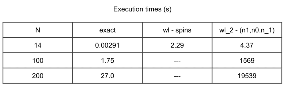

One last thing, I also attach here a table with the execution times for every program, just to remark that for N=14 the first code is faster than the second one. Not sure if that is true for larger N's.
