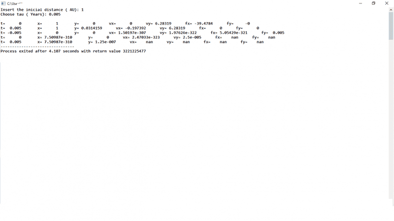

I'm writing a program to compute an ODE solution of the Kepler's problem based on Runge-Kutta 4th order method and today I've past the whole day trying to made it work, but I've failed, maybe you could help me to kill the problem ?
The solutions is cartesian.
Look like when it takes n=1 there is some error that make the force in x and y equals 0, as you can see in this print screen, also it crashes on n=5 :c
I would be gratefull if you help me.

Your problem is simple: Arrays in the C family of languages start at zero rather than one.

Dont know if i got it , but when you say it starts at zero you meant for example:
double x[4] = x[0] , x[1], x[2], x[3] and x[4], right ??
Case yes, there should not have any problem, cause I'm using n starting at 1 in the loop, these coordinates still exist.

That is not right. What double x[4] does do is to declare x as an array with four elements, accessed as x[0], x[1], x[2], and x[3]. The element x[4] does not exist.
Your code is incorrect in a number of other ways. You are not implementing RK4 correctly.
Example pseudo code RK4 step, p = position, v = velocity, a = acceleration. p[] and v[] don't have to be arrays, just using the syntax of [ i ] as a step indicator. In this case (Kepler), acceleration is a function of position (the velocity parameter is not needed).
