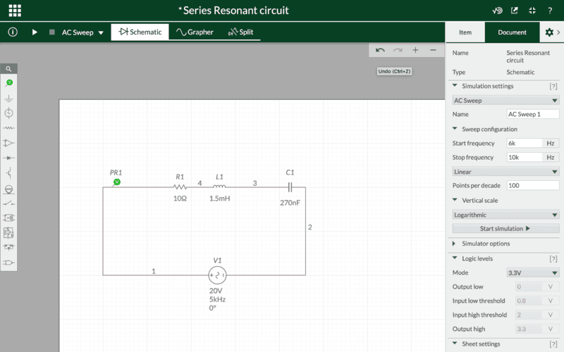

circuit is as follows
series circuit
Voltage 20V 5khz - R10 ohms Inductor 1.5mh Capacitor = 270 nF

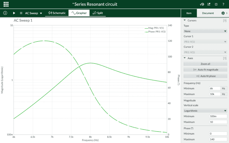

this is what i created so far, but not quite sure how to get the resonance curve, i tried to enter it in settings and do an AC sweep

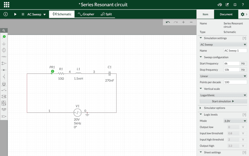

What voltage are you measuring? Where is the ground node?
20V 5khz, should i be looking at the current ?

I don't know what you are supposed to do. Your supposed to tell us.
But, that looks good to me. Except somethings wrong with the magnitude scale. At resonance the current should be ##I = V1/R1##. This is because at resonance the complex impedances of the reactive components will cancel each other and sum to zero. Does your voltage source have any impedance built in?
The phase looks good though, so it's something about the plot scale, I think.
edit: Oops! No sorry. There is something wrong with the magnitude. With Q=7.5 you should have more peaking at resonance. The asymptotes should intersect about 7.5x lower than the current peak at resonance.
edit#2: Never mind the peaking bit. I misread the plot. I'm more familiar with a log(f) scale which will show the linear asymptotes more clearly.

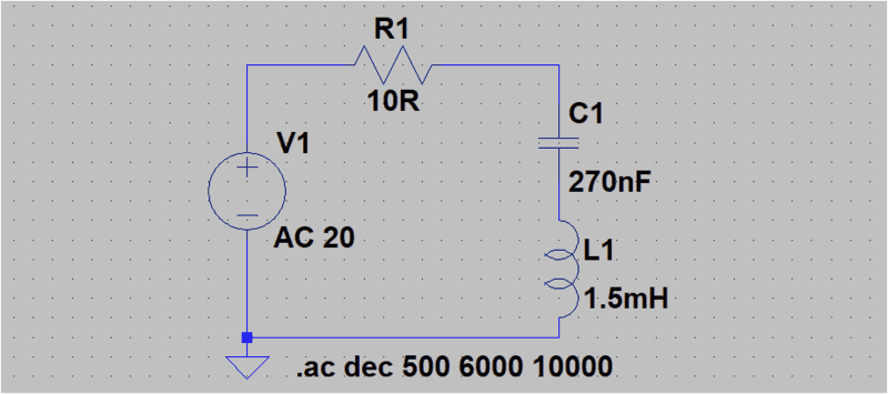

The same circuit as simulated by LTSPICE. The magnitude, in dB, is of the current in the series circuit.
