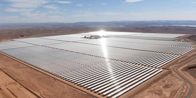

Let us check with the $9 billion dollar price tagged parabolic trough solar farm in Morocco:
https://en.wikipedia.org/wiki/Ouarzazate_Solar_Power_Station
Calculate the power density on land:
Given official data -- the finished NOOR I stage 450 hectares on land characterized as 2635 kWh/m^2/year, its salable capacity 370 GWh/year.
We deduce:
1. Yearly receivable irradiation average power = 2635*1000/(365*24) = 301 W/m^2
It is reasonable, because the solar power density above atmosphere 1360 W/m^2, and the Earth surface area = 4*Pi*Radius^2 = 4 times of central circle area = 4 times sunshine projection area, thus the theoretical average diffused heat power density = 1360/4 = 340 W/m^2. The measured value 301 W/m^2 sounds right.
2. The infact harvested power density = 370 GWh/year / 4500000 m^2 = 370,000,000,000/(365*24)/4,500,000 = 9.4 w/m^2
3. The average efficiency of heat-to-power = 9.4/301 = 3.1%
4. The transient quasi efficiency at noon moment = 9.4/1360 = 0.7%, only this data can be compared with the PV nameplate efficiency 12%.
Instant question: now that the transient efficient of this mirror-molten-salt system so tiny 0.7%, why not to use PV?
5. As per previous vague threshold of plantation reference frame 0.18 W/m^2, its power density is 9.4/0.18 = 52 times greater.
6. We can see large gap between adjacent rows of parabolic troughs array. It seems that the power density could be doubled if narrow the gap to almost zero.
Is any my calculation wrong?
You can double the power density when the sun angle is high. The density is not doubled at times of day or seasons of the year when the sun angle is lower. You might also be giving up convenient access for maintenance and repairs. Then there is the question of how increasing density increases profit. If land is cheap and troughs are expensive then density is not an important metric.
What are you trying to calculate?
Likes russ_watters and jbriggs444
