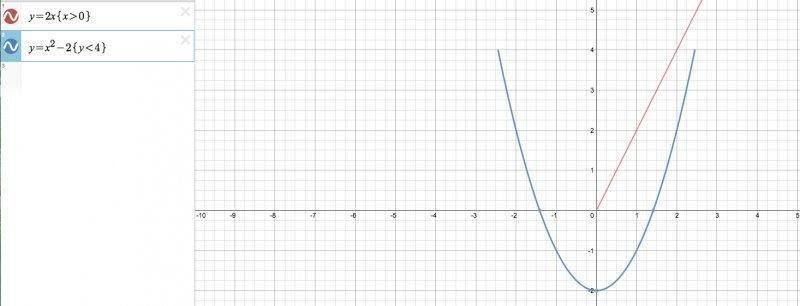

Thanks! I'll give it a try. Is there ways to add inequalities. For example if I am drawing a line but I want it to stop at a certain point, I can say like x < 15
WolframAlpha is interesting, too.
Limits: "plot x^2, x from 2 to 4"
There is a "hack" if you cannot directly draw inequalities: sqrt(x-a)/sqrt(x-a) is not well-defined (for most plotting programs) for x<=a and 1 for x>a. It is possible to include an upper limit in a similar way.
Yes you can. You can look at the help area of the site: is the screenshot (attached) the type of thing you were interested in?
