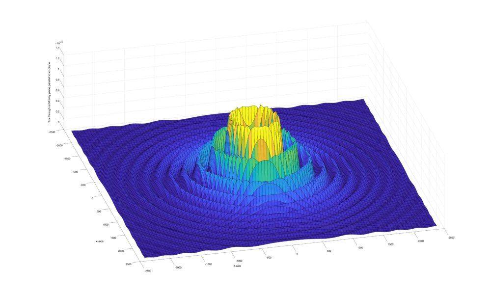

I want to get a diffraction pattern from a circular hole in the Franhofer limit. In another thread I have been studying radiation patterns of various configurations and now I seek to study diffraction. I want to see if it's possible to place electric and magnetic dipoles in the vicinity of the hole and produce a respectable diffraction pattern on the far wall. The hole is in the XZ-plane and I want to graph the flux through a far away y = constant plane. I'm assuming normally incident plane wave through the hole.
From Jackson 9.16 we have the following equations for the vector potential of a radiating electric dipole and radiating magnetic dipole.
$$\vec{A} \left(\vec{r}\right) = - \frac{i \mu_0 \omega}{4 \pi} \left( \frac{e^{ikR}}{R}\right) \vec{p}$$
$$\vec{A} \left(\vec{r}\right) = \frac{\mu}{4 \pi} \left( \frac{e^{ikR}}{R^2} \right) \left( -ikR + 1\right)\vec{m} \times \vec{R}$$
(I don't think the last formula is in Jackson but I have used it to create a qualitatively accurate animation of a radiating magnetic dipole)
Naturally the ##\vec{B}## and ##\vec{E}## can be calculated by taking the curl and multiplying by the appropriate constant in the latter case.
$$\vec{B} = \nabla \times \vec{A}$$
$$\vec{E} = \frac{i}{k \sqrt{\mu \epsilon}} \nabla \times \vec{B}$$
The Poynting Vector field can then be found by taking the real parts of ##\vec{B}## and ##\vec{E}## and doing a cross product.
$$\vec{S} = \mathfrak{R} \left( \vec{E} \right) \times \mathfrak{R} \left( \vec{B}\right)$$

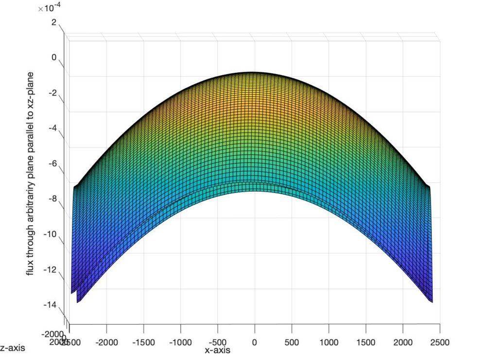

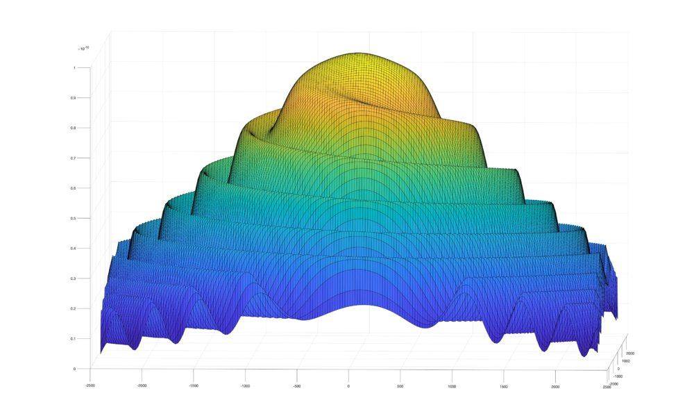

I oriented a magnetic dipole perpendicular to the hole (parallel to the ŷ ŷ y^ŷ direction) with one end at it's origin and I get the following pattern
I was really looking for something like this
As you can see I'm getting almost the exact opposite of what I want since I'm going for Fraunhofer Diffraction. Conventional wisdom would suggest "if you want the exact opposite do the exact opposite". I have tried making the magnetic dipole parallel to the hole and I lose rotational symmetry in the flux symmetry on the back wall which is something I would not have expected.
I am open to suggestions and although I have tried many different combinations only to start back at square 1.
I would think I need to add more sources and separate them so as to have path length differences. Should they be electric dipoles or other magnetic dipoles.

I believe I captured "Fresnel Diffraction" by putting a single electric dipole in the y-direction . Of course when I do this the radiation flux disappears on the axis making it pretty much impossible to get a central maxima (what I was hoping for with "Fraunhofer" diffraction).
Then again maybe when I take a closer look at my program I will find the choices of wavelengths and distances do not conform to that limit. I'll take a look at it after dinner.
Maybe I trivially plotted the flux pattern of a single electric dipole and it resembles Fresnel Diffraction by mere coincidence.

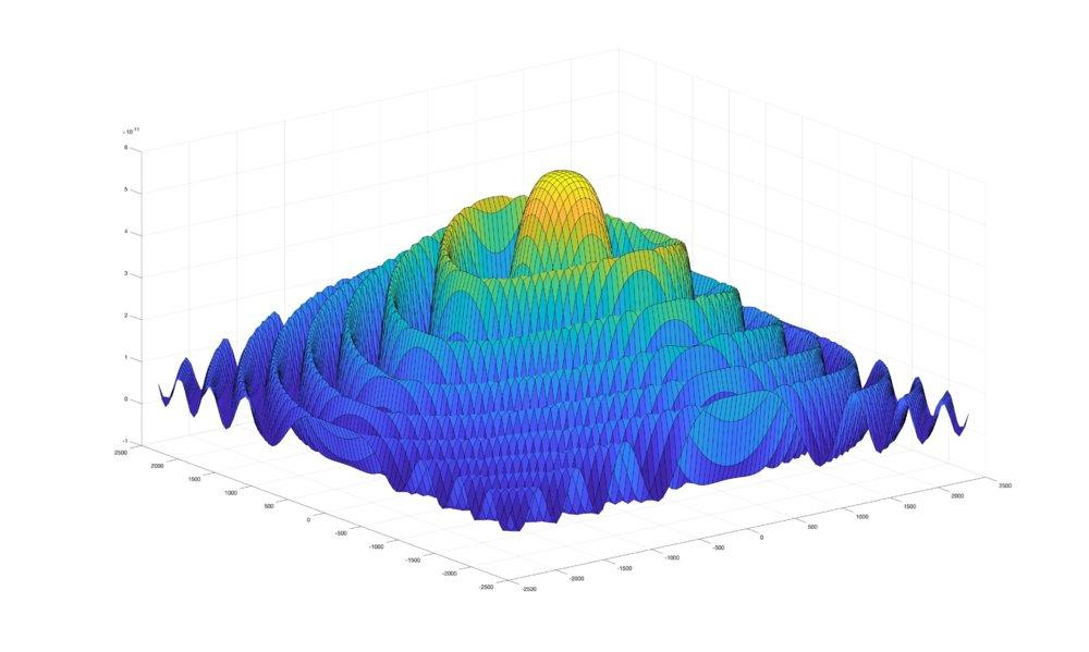

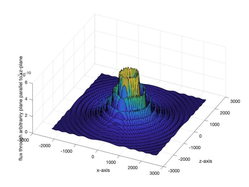

So I've been doing some reading and looking around and indeed according to the book "Applied Scanning Probe Methods II: Scanning Probe Microscopy Techniques" (Novotny and Hecht)
and the supposed far field diffraction pattern of circular aperture can be reproduced by this substitute arrangement (According to Bethe and Bouwkamp).
To me this is insane. I don't see how you can get a central maxima in this configuration because to my understanding radiation disappears on the axis of the dipoles (in this case ##\vec{p}##).
I have used my programs to produce a qualitatively accurate pattern of both kinds of dipoles. I combined them and I am getting the following
Pretty much the same as my last one. This time with supported literature (that doesn't seem feasible to me).

I set the radius of the circle equal to
a=1a=1​
and
k=5π1000⇒λ=2πk=400k=5π1000⇒λ=2πk=400​
I think that conforms to the long wave-length limit.
I cut the figure with the
y=460yy=460y​
plane. Perhaps I should do it over 10 to 100 wavelengths?
Edit: The units on the vertical axis is Poynting Flux of the y-component of the Poynting Vector. (I don't know the units for the Poynting Vector of the top of my head).
I'm so sorry for the Latex messing up. The aperture has a radius of 1. The wavelength is 400. I cut with the y = 460 plane.
The units on the vertical axis is poynting flux through the plane. I.e. the y-component of the poynting vector.
A good test of your calculation might be to cut the wave length to 40 (factor of 10) and see how stuff scales. Just do one thing at a time!

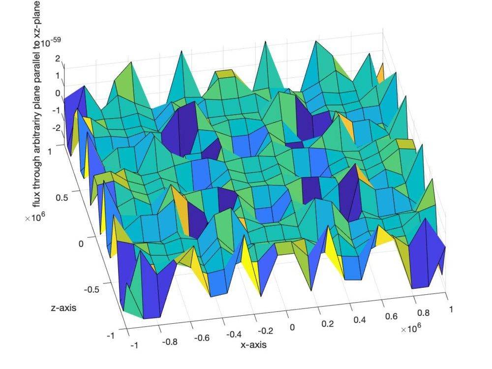

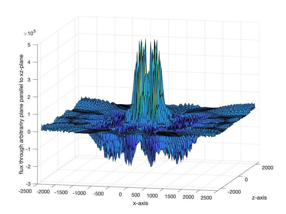

I cut it down to 40 and for some reason I lost cylindrical symmetry. That doesn't make sense to me.
It's just hard for me to imagine there being radiation on a dipole axis.
I'm flying blind here...the only square in the problem is your calculation mesh (?) ...is that showing up in the result suddenly (?) . Well I'm shot for the eve...

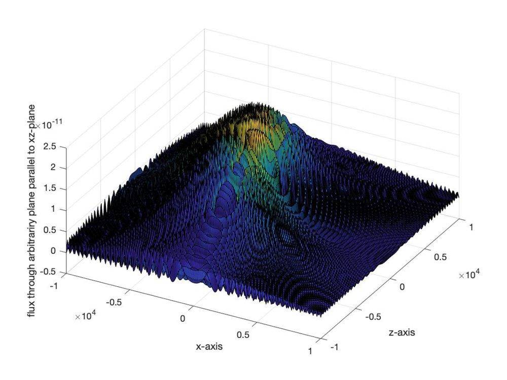

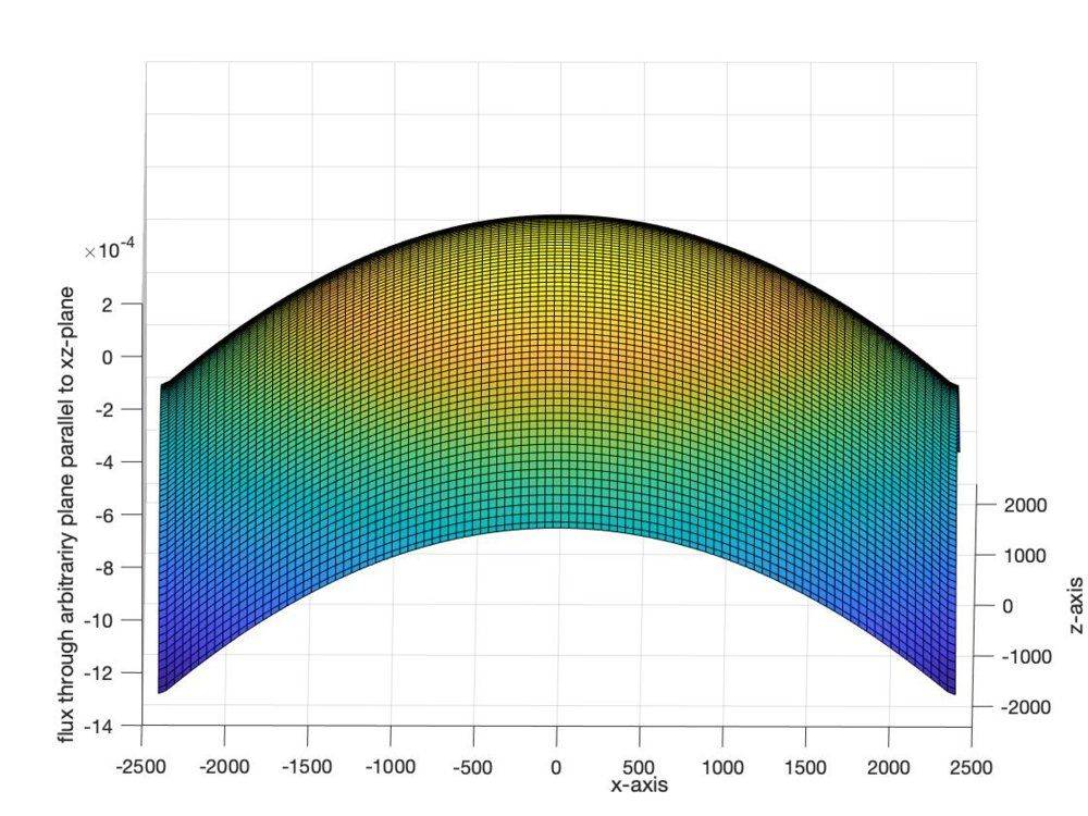

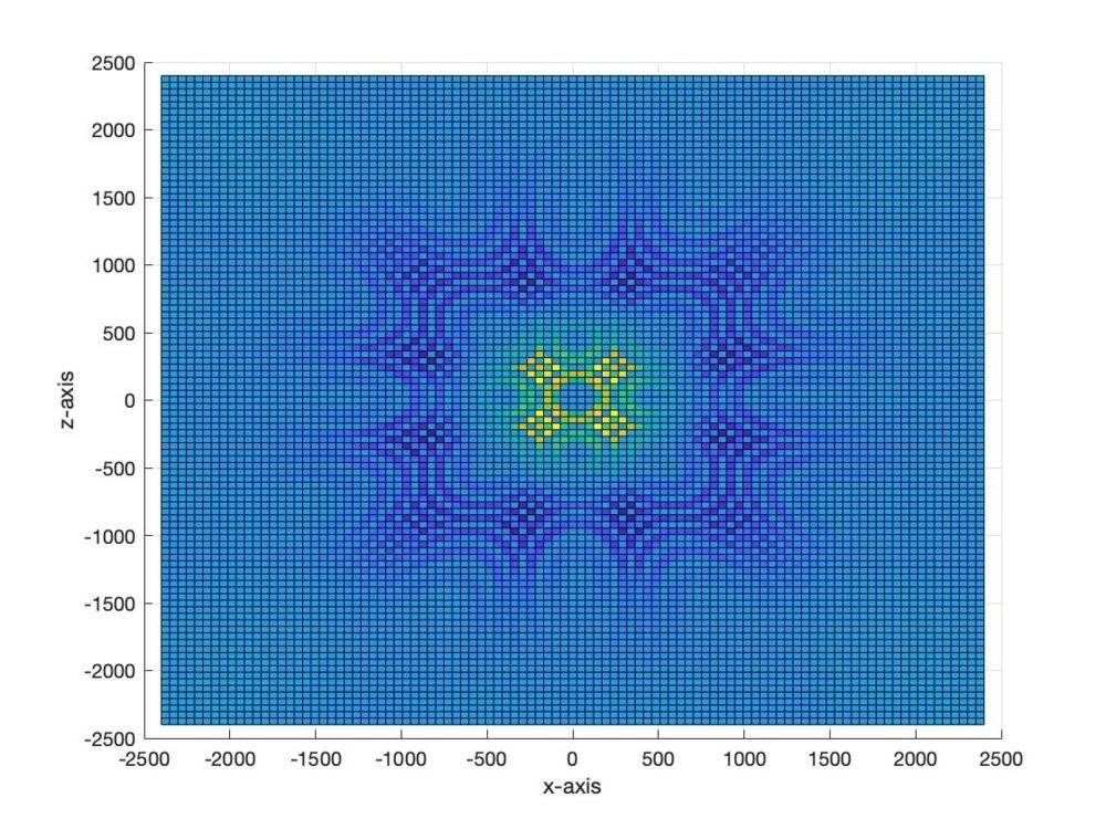

Strange to say the least. I'm going to try and pointing the vector radially at each point in the sphere. I'm afraid I'll get vanishing radiation everywhere but it doesn't hurt to try.
Not getting any better. If I programmed that right then that is not what I'm looking for.
Should the flux be negative? Actually can it be negative if your calculation is working?

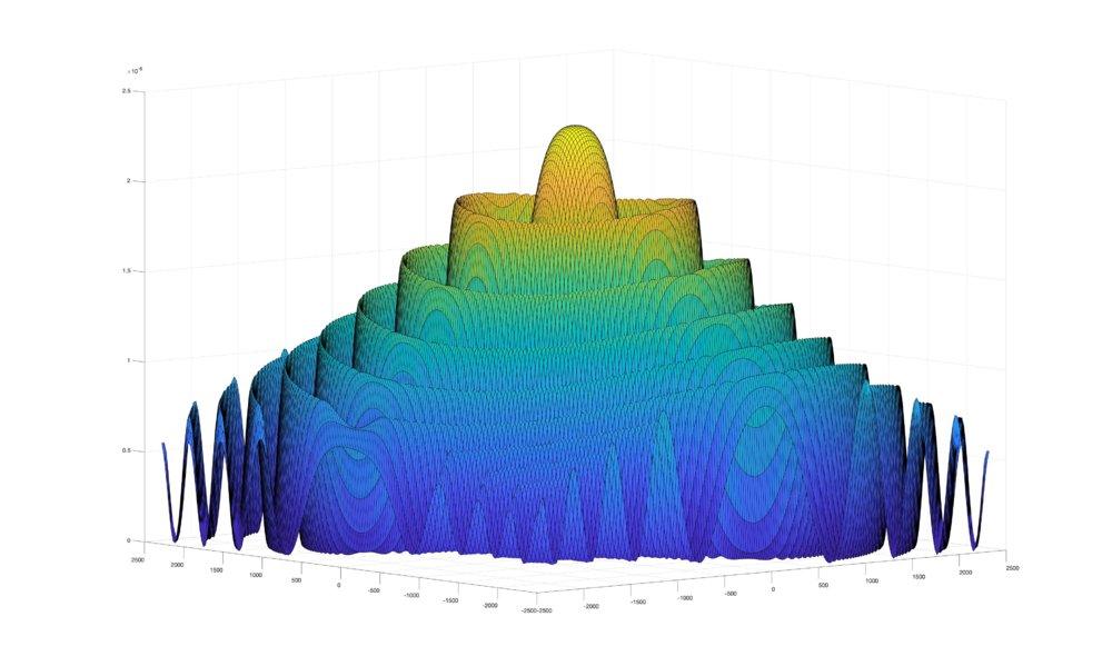

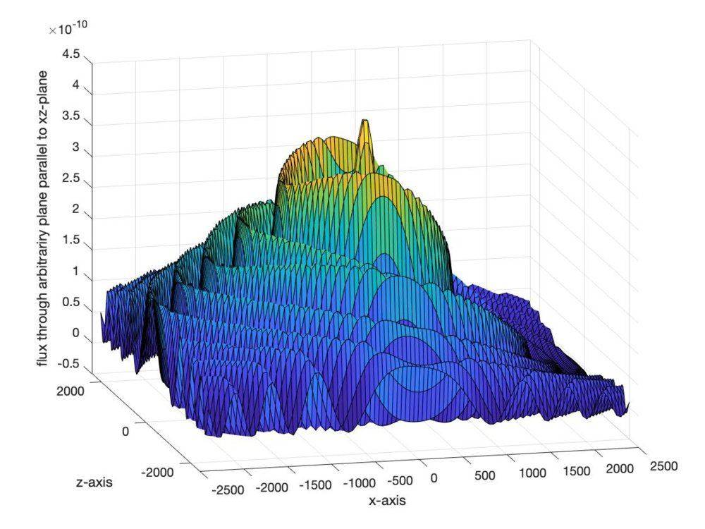

This is the best I've gotten. Again this is flux through a ##y = constant## plane. I got this by putting a dipole at the origin and pointing it in the ##\vec{p_1} = (0,1,2)## direction. My first thought was to put another dipole at the origin and point it in the ##\vec{p_2} = (0,1,-2)## direction to bring up the other side of the envelope and accentuate the peak but that just gives us a dipole pointing along the y-axis (i.e. cylindrically symmetric flux pattern but no central peak as before).
Instead what I'm going to do is put ##\vec{p_2} = (0,1,-2)## on the ##y-axis## far away from the origin. Hopefully that will bring up the envelope on the other side, accentuate the peak, and not cancel out (because ##\vec{p_2}## is so far away from ##\vec{p_1}##.
When I extend the scale of the problem at the beginning of this post to ##\approx 10## times I start losing the central peak. When I extend the scale of the problem at the beginning of this post ##\approx 100## times I start getting negative flux. The only thing I changed was the extend of the grid, nothing else and I'm getting very weird results.
I also tried taking the sphere of dipoles and shrinking by a factor of 100 in hopes of getting rid of the negative flux to no avail.

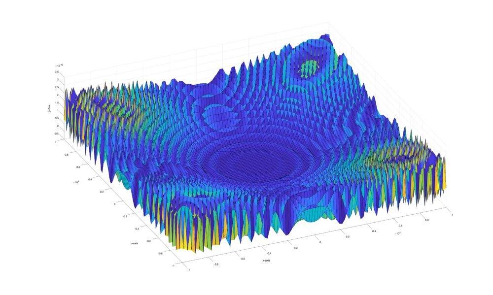

I made ##\vec{p_1} = (0,1,2)## @ ##(0,0,0)## and ##\vec{p_2} = \frac{1}{10} (0,-1,2)## @ ##(0,-constant,0)## where the constant is far away from the diffracting aperture.
Getting more coverage with the envelope while maintaining the peak. If I deviate from multiplicative magnitude constant ##\frac{1}{10}## I start to lose desirable features.
Still not getting full coverage though. I might sound crazy but I really think going forward the strategy is to move away from the aperture on the incident side and start introducing electric and magnetic dipoles in that region. It has gotten me the best result thus far albeit not perfect.
Nvm I programmed my separation vectors from the two dipoles wrong. The picture above is therefore not valid.

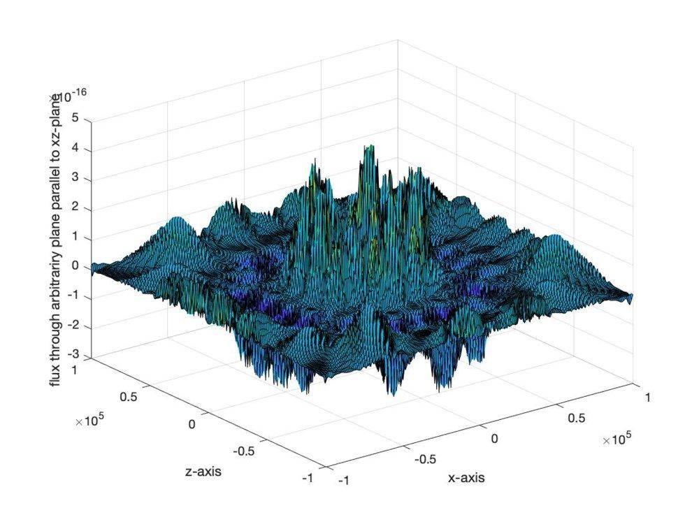

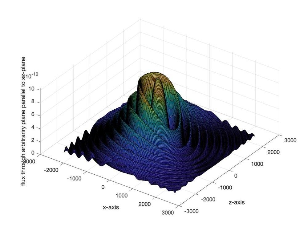

I have no idea what I just did (I literally just played around with moment values and position) but I'm going to review my script to make sure it's not physical nonsense. Hopefully it's not because I'm really happy with a seemingly cylindrically symmetric (positive) peak with smaller ripple peaks around it. This is definitely progress.
Note that my previous picture that I was ecstatic about had a peak value of 0 which is not desirable.
Also, my peak value is about 10 times the second peak which is probably not typical of diffraction.
I'll have to figure out a way to "tighten" my parameters but this overall shape is good.

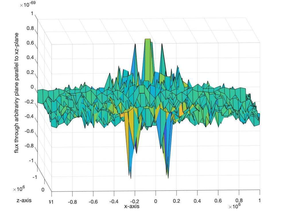

Just for thrills I Lorentz transformed the fields of an oscillating dipole in the z-direction (while traveling in the x-direction) and took the flux through a ##x = constant## plane. I think this is an improvement?
I made ##\beta = 0## and I get the same thing pretty much so that was pretty much fruitless.

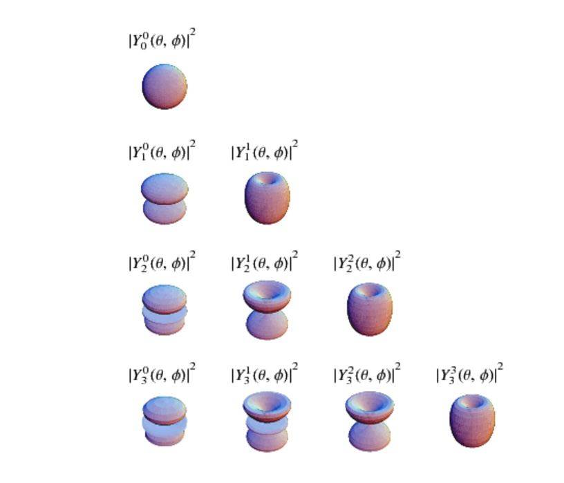

@TSny may I ask a question about spherical harmonics? In the previous thread where you helped me extensively we were able to produce the shapes made by ##\left|Y^1_1 \left( \theta, \phi \right) \right|^2 ## and
##\left|Y^1_2 \left( \theta, \phi \right) \right|^2##. I'm interested in creating
##\left|Y^0_1 \left( \theta, \phi \right) \right|^2## if possible with some distribution of charge/current. From my very cursory understanding of things it is somewhere between a monopole and a typical dipole?
I believe this could give my a locally spherically symmetric surface and therefore a cylindrically symmetric flux pattern indicative of diffraction through a small circular aperture. Maybe I'm barking up the wrong tree.
