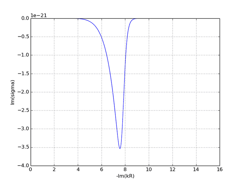

Here's the plot of sigma.imag along the negative imaginary semi-axis:

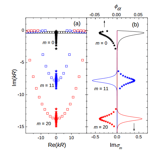

Here's what it should look like (look at the blue m=11 curve at right):
As you can see, it looks sort of right, but it's taking on the wrong values.
These equations and the graph come from page 4 in this article: http://arxiv.org/pdf/1302.0245v1.pdf. Something that the article mentions is that sigma should be a purely imaginary function. I examined the function to see what could be making it part real and part imaginary in my case. I found that the Dm's in the denominator of sigma have equal real and opposite imaginary parts, so I expanded the product to ensure that it comes out purely real (the precision of the two numbers lead to an imaginary part which shouldn't have been there). Still, it isn't working out. Any help would be appreciated! I've been stumped for half of the summer by this one.
