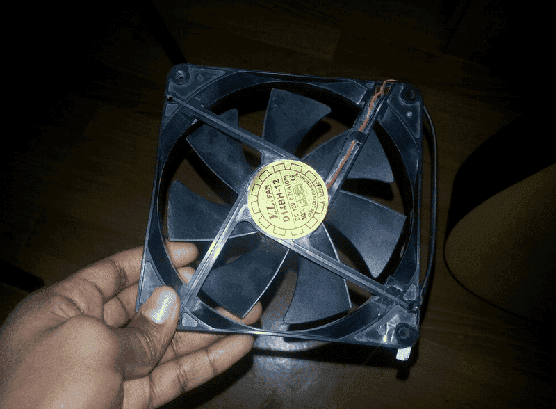

Basically, I want to build a small wind turbine in order to charge a smartphone or a tablet and so far I have the following:
1. I found a rather big computer fan and these are its specifications:
Name: Yate Loon D14BH-12
More: 2-pin, 12V, 0.7A @ 2800RPM, 140CFM, 48.5dBA
Here is a photo:
So my question is:
- If this fan needs 12V in order to work and it's RPM is 2800, could I use it the other way around? I mean, Use the wind in order to create energy.
Note: I made a small test connecting a small LED and I made the fan spin and it turned on a little bit for a little while (about 2-3 seconds) and it's obviously because of the poor spin I created.
I live in a pretty windy city and I wanted to know what would happen if I'm able to reproduce those 2800 RPM? Would that create 12 volts?
- If so, how can I know the amperage? Because the smartphone needs ~2.1 amps and 5 Volts DC to charge.
- So, If I get those 12 volts, would it be necessary to reduce them to 5 volts? or can I send 5 volts to the smartphone and 7 volts to a secondary battery that I could use later on in order to charge the smartphone when there is no wind?
Note: I could use a smaller fan in order to get those 5 volts.

That type of fan typically uses a brush-less DC motor. This type of motor is a multi-phase electrically commutated device. You will not get any power out of it unless you replace the circuit.

I've never tried it but an n-phase bridge hooked up correctly would give you something. I just checked a broken one I have here. It has a rather weak vinyl magnet in it. I doubt much power would be created even if you modified it.
You also want lots more swept area to get any usable amount of power. If you want to use broken computers for power your best bet is to use the magnets out of several hard drives. You might be able to get a reasonable amount of magnet wire out of the power supply too.

A permanent magnet mechanically commutated DC motor can be used as a generator without modification. Most other types need some added circuity to be used as a generator. There may be some types that will not work at all as a generator.
The application as a phone charger will need some voltage conversion no matter what. It is unlikely that you will get exactly 5V out of any kind of generator.

Both of those videos use permanent magnet mechanically commutated DC motor for the generator. The PC fan is just used for the fan blades. The two motors likely have different numbers of windings on the armature and are spun at different speeds so they produce different voltages.
