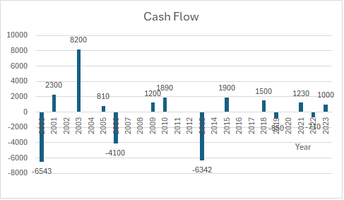

(1) Plot the Cash Flow
(2) Using excel formulas, calculate the present worth of the project.
(3) Using excel formulas, calculate future worth of the project at the end of year 2023.

Is this the right method for solving this problem? Is there a simpler approach? Can it be solved using Excel functions? e.g.
Present worth =NPV(i%,second_cell:last_cell) + first_cell
Future worth = FV(i%, n, A, P) ?

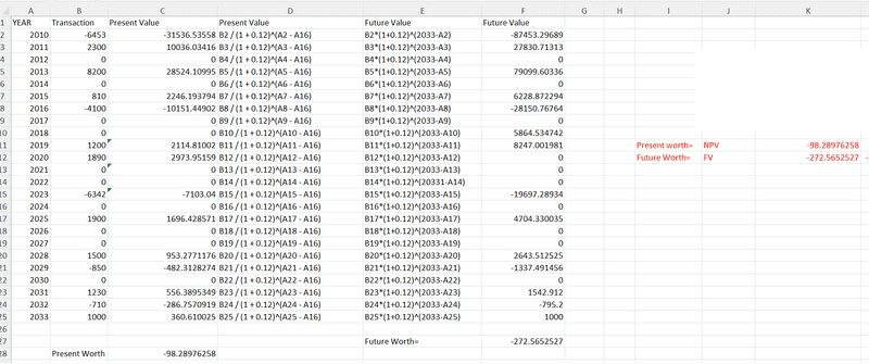

Okay I took your advice and
2010-2023 years in the past (their worth should be higher considering the interests rate) and values in 2025-2033 that their worth should be lower in 2024.) This is because we are discounting the future amount back to the present year (2024). The formula correctly accounts for the time value of money,.
What if we use present values calculated by individual formula
(cashflow/(1+r)^n)
calculations per cell;
B2 / (1 + 0.12)^(A2 - A16)
B3 / (1 + 0.12)^(A3 - A16)
B25 / (1 + 0.12)^(A25 - A16)
=sum() cell to add all those values and for future we do similar formula
(cashflow*(1+r)^n) )
B2*(1+0.12)^(2033-A2)
B25*(1+0.12)^(2033-A25) =sum() cell to add all those values.
Would this be valid?
Looks OK. Note that instead of B2 / (1 + 0.12)^(A2 - A16), if you enter B2 / (1 + 0.12)^(A2 - A$16) (note the $ sign) you can copy this code down to the rows below and it will keep the reference to A16 static.
Likes LittleJonJon
