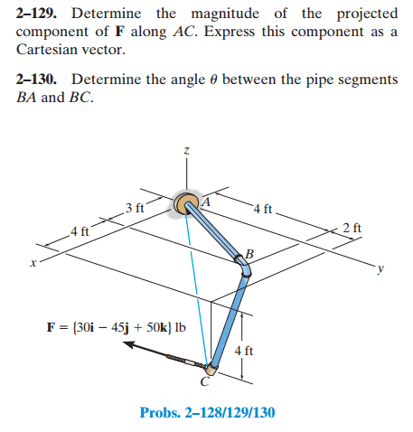

Projected component of F along a line in cartesian question.
In summary: Fca = F {30i -45k +50k} * Uca ({7i +6j -4k}/ Sqrt(7^2 + 6^2 +4^2)) This would give you -17i, -6j, and +5k for C.
7Lions
Determine the magnitude of the projected component of F along AC. Express this component as a Cartesian vector.
Information I'm working with.
Most of my attempts have proven fruitless.
I understand that in order to find a component of F along AC we'd need to have the Uac but I'm just having difficulty finding the cartesian coordiantes for segment AC.
Cosine law comes to mind but how would you apply cosine law in cartesian for a 3D image?
Also, do the signs for the cartesian coordinates of AC become times by a (-1) as the force is protruding outwards from point C?
Any help is much appreciated. I've been stuck on this question for a good 5-6 hours now.
Thanks!

Appreciate the quick reply Simon, I see AB's triangle but I'm having trouble finding a relation between AB and AC.
The answer at the back of the book yields Fac = -25.87 lb ( -18.0i -15.4j + 10.3k)
I don't really understand how they can come up with an answer that has i and j being negative values.
* = dot product
Fca = F * Uca
Where Uca = Cartesian of CA / Sqrt( each cartesian coordinates of ac^2 of)
Now my question narrows down to: How do I incorporate the cartesians given to yield the cartian coordinates of CA?
Initially I had thought that
Fac = (F* Ucb) * Uab
But that wasn't the case. :(
Can you see from the figure what the x, y, and z components of the position vector from point A to point C are? In other words, what are the coordinates of point C? For example, from the figure, I can see that the z coordinate of point C is -4 ft.

AC is the vector pointing from point A to point C.
Thus AC = C - A. This is true no matter what the coordinate system is.
You are all-but given the cartesian coordinates of A and C.
Look carefully at all those measurements in feet that the diagram is peppered with.
[edit] chet has given you a hint there...
Just above C there's an intersection of three black construction lines. What are its coordinates in the XY plane? what, then, are the coordinates of C?

Yea I do. The coordinates for point C are { 7i + 6j -4k}
I've tried applying the dot product of point C's coordinates to the force but didn't come to the correct answers.
My work:
Doesnt give me the negative i and j that I'm supposed to be getting.

It looks like you have the right idea. This is the way I would have done it. Is it just the overall sign that's wrong, or are all the individual components wrong. Maybe they wanted you to dot it with the unit vector in the direction from C to A, rather than from A to C. That would flip the sign.
Chet
Not only are the values incorrect but the signs are as well Chet.
Following through with the calculation using C-A (-7,-6, +4) I end up with : {-20.895i + 26.866j + 19.9007k}
which is a ways off from the ( -18.0i -15.4j + 10.3k) answer.
A-C Yields (+, -, -) values
C=(7,6,-4), A=(0,0,0) then AC=C-A=(7,6,-4) is the vector from A to C.
The vector from C to A is CA=-AC=(-7,-6,4)
The direction of AC is the unit vector AC/|AC|

OK. But consider this: The unit vector in the direction of the "correct answer" is the same as the unit vector in the C-A direction, while the unit vector in your answer is not. That is:
18.01/7 = 15.4/6 = 10.3/4 = 2.57. My conclusion is that you must have made a mistake in arithmetic. What did you get for the dot product of F with the unit vector in the direction of CA? It should have been 25.8 N.

I dot producted the force and the unit vector ac (7/10 i , 4/5 j, -2/5k) and got 46.22N

The sum of the squares of the components of AC is ~101, so the length of AC is ~10.
So the unit vector in the direction of CA is -0.7 i -0.6 j + 0.4k. So now, please try again with that dot product.
