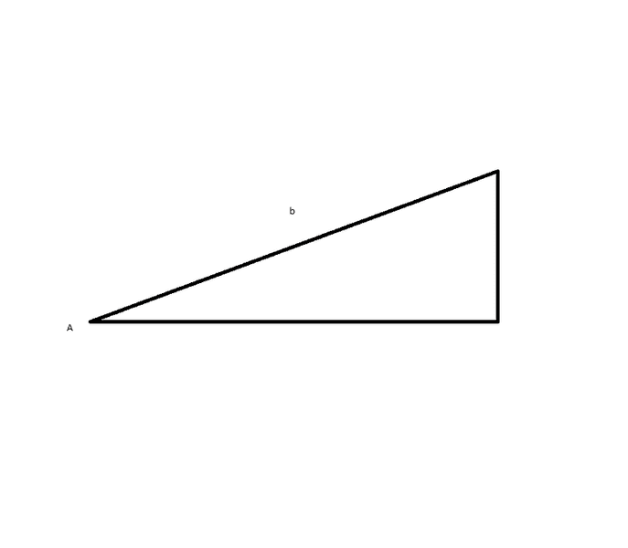

A test rocket is fired from rest at point (A) along (b) a 200m incline, accelerating 1.25 m/s2
Given:
b = 200 m, the angle at point A is 35°, a = 1.25 m/s2
a) Find the maximum height above the ground.
b) Find the greatest range.
If it was a constant velocity I would have no problem solving this but I don't know how to deal with this acceleration. My book doesn't seem to help me, it is rated the most difficult in the chapter of 2-3D motions. but there are no examples with varing acceleration in the horizontal direction.

Hint: Consider dividing the problem into two parts.
does it make sense to find the final velocity at the 200 m mark on the ramp then calculate the height of the triangle and then go from there?
Yes. That is splitting in two parts...
And: you seem to think the horizontal acceleration is varying. Why ?

I went to bed, but today we're at this point:
vf2 = vi2 + 2 * a * d
vf = sqrt(0 + 2 * 1.25 m/s2 * 200 m) = 22.361 m/s
The height of the triangle is, sin(35°)*200m = 114,7m = a
-114.7m = (22.361 m/s * sin(35°))*t+(-½*9.8 m/s2 * t2)
0 = -½*9.8m/s2*t2+sin(35°)*22.361m/s*t+114.7m
Δt = (-sin(35°)*22.361m/s ±sqrt((sin(35°)*22.361m/s)-4*(-1/2*9.8)*114,7m)) / -9.8 m/s2
Δt =+√ = -5,73s , Δt = -√ = 3.776s

also I am a bit confused with this equation how would I find the initial velocity at the end/top of the ramp.
all I know is x = 200 + 0 + 1/2 * 1.25 * t^2, I don't know either x or t
At the end of the ramp you already found v = 22.36 m/s (vx = 18.32 m/s, vy = 12.82 m/s). From there you also found a flight time of 3.77 sec (I found 3.704, actually (using g = 9.8 m/s2) -- perhaps you can check; the other one was -6.32 s) ).
From that point the horizontal motion is uniform, so distance covered is just ##v_{0,x} \, t##, your 67.2 m (my result was 67.8).
I think you did well, but made it more complicated than necessary...

I used v = 22,361 m/s vx = 18,3 m/s vy = 18,3 m/s flight time = 3,776s using g = 9,8 m/s2 the negative time had a larger difference compared to yours, I have -5,73s
I think I made a mistake during the flight time calculation
(-sin(35)*22.361-sqrt((sin(35)*22.361)-4(-1/2*9.8)*114.7))/-9.8 = 6.16s
(-sin(35)*22.361+sqrt((sin(35)*22.361)-4(-1/2*9.8)*114.7))/-9.8 = -3,54s
This is using a calculator I know how works, the other numbers was from Maple which i think always calculate in radians unless you do the 1/180*pi conversion

Yep I forgot to square b under the root.
so my delta t's er now -3,7s and 6,32s
Btw don't you have to divide by negative g and not positive?
o:) Oops. Brilliant ! Sounds very reasonable to me :smile: and gets the projectile a little further as well. Perhaps we should top it off with a drawing showing the trajectory (y versus x) !
[edit] Must have more coffee (again): at the launch from the top of the ramp back in time the parabola should be shorter than forward, so physical intuition should have kicked in and objected right away !

As you can see from my earlier paint drawing, drawing is not a set of skills I was blessed with.
And I guess the questions are done if I just fix the b^2 and correct the calculations using the time.
Δt = (-sin(35°)*22.361m/s ±sqrt((sin(35°)*22.361m/s)2-4*(-1/2*9.8)*114,7m)) / -9.8 m/s2
Δt =+√ = -3,7s , Δt = -√ = 6,32s

x = (v0*cos(-35°)*t = 22,361 m/s * cos(-35°)*6,32s = 115,76m
47,96m + 115,76m = 163,7m
Something tells me this last part from x = ... is incorrect.
Is 22,361 m/s * cos(-35°)*6,32s the range of the rocket from the top of the ramp and to the ground 114,7m below?
