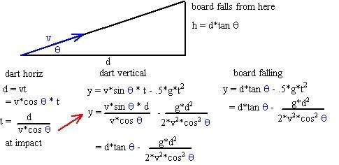

Question: At the instant a dart is launched at a high velocity, a target (often a cardboard monkey) drops from a suspended position downrange from the launching device. Show that if the dart is aimed directly at the target, it will always strike the falling target. (use a specific set of numbers).
Variables I decided to use:
velocity (v1= 100m/s
angle shot at = 45 degrees
time = 10 seconds
d(t) = (v1cosx)t + (v1sinx)t - 1/2(g)(t)2
Therefore:
Horizontal - x = (v1cosx)t)
Vertical - y = (v1sinx)t - 1/2(g)(t)2
This is the start in the problem. I'm not exactly sure how I'm supposed to prove it. I started with finding the horizontal and vertical.

You have a good start. There are many ways you can answer this question, but since you are asked to invent some numbers, here is what I would do. I would choose the horizontal and vertical distance of the monkey to be something like lecture hall size, no larger than 20 m. If these are equal, then the aiming angle is 45o, if they are not equal you can easily do the trig and find the angle. I would choose a reasonable dart speed knowing that 20 m/s is 45 miles per hour.
Then I would write two sets of kinematic equations, in the x and y directions, one set for the dart's motion and one for the monkey's motion. I would use the horizontal equation to find how long it takes the dart to get across (time of flight). Finally, I would plug the time of flight in each of the vertical motion equations separately and show that the dart and the monkey would be at the same height above ground.

The monkey kinematics equations are incorrect. If you decide on using an origin for the dart, you must use the same origin for the monkey. Your monkey x equation says x = 0 and y = -9.8t. That says that at t = 0, the monkey is at point (0,0), right where the dart is. That's not the case. Initially, the monkey is at (10,10). Write kinematics equations that reflect that.

Interesting that the general solution is no harder than the example.
I am glad you got it, polak333.
Even more interesting is to note that this can be explained without equations. Both objects are in free fall, therefore their velocities change exactly the same way. Thus, their relative velocity is constant and, if the dart is initially aimed straight at the monkey, it will remain aimed straight at the monkey.
