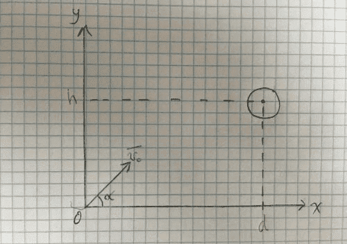

An archer launches an arrow from coordinates ##(0, 0)## at an angle ##\alpha## and with an initial velocity ##v_0##. There's a target located ahead of the archer and the center of that target is at coordinates ##(d, h)##. At what ##v_0## and at what angle ##\alpha## does the archer need to launch his arrow to hit the center of the target perpendicular to its surface?
Your image suggests that the target is a sphere, but your solution and the formulation suggests that it is a vertical surface. I am going to assume the latter.
Sorry for the confusion. Your assumption is correct.
