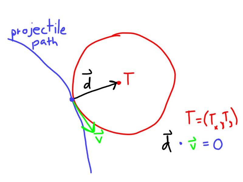

To find the minpoints. ν⋅d = 0 is used where:
ν=velocity vector= xdot*i+ydot*j
d=vector from projectile to target=(T_x-x)*i+(T_y-y)*j
Target location = (T_x,T_y)
The code will solve for when v⋅d is equal to zero. Here is a picture illustrating that instance:
edit: I realize the velocity vector should fall inside of the blue, my mistake

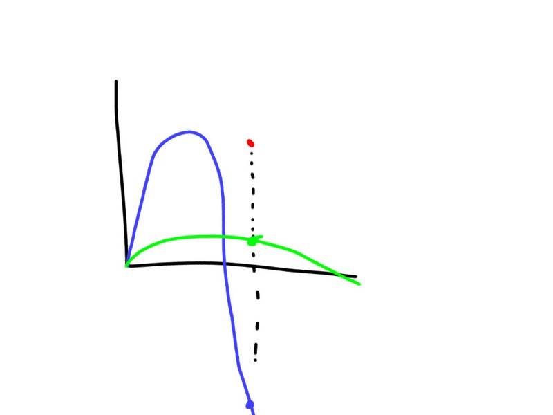

That method still runs into the same problem. With a high shot I can still land underneath the target in the same way that a low shot can. Here's a pic: (starting velocities aren't constant, blue path should be higher, but you get the idea)
For a given starting velocity there should usually be 2 different paths to the target. A "direct" path, and a "high" path that runs into excess air resistance before dropping onto the target. It doesn't matter which path I use, but I do need to realize which path was attempted and was hoping there was a way to determine this before a solution is found.
You don't need to know which path case you are. You just need to find (possibly numerically) the derivative of y intercept with angle for a starting guess. That tells you which way to go for that starting path.
