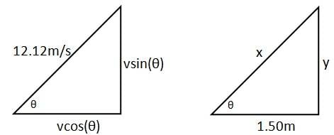

A toy gun uses a spring with a force constant of ##\small{300 N/m}## to propel a ##\small{10.0\!-\!g}## steel ball. If the spring is compressed ##\small{7.00\ cm}## and friction is negligible:
At what angles above the horizontal may a child aim to hit a target ##\small{3.00\ m}## away at the same height as the gun?

Then I broke the velocity and the displacement into their components (I skipped the units for simplicity). I used just half of the range, hence I took ##\small{d = 1.50\ m}##:
##\sin(\theta) = \frac{y}{x} \Rightarrow x\sin(\theta) = y##
##\cos(\theta) = \frac{1.50}{x} \Rightarrow x = \frac{1.50}{\cos(\theta)}##
##y = 1.50\tan(\theta) \hspace{35pt}(1)##

I don't know why I get this horizontal displacement. I expected to get ##\small{d = 1.50\ m}## and not the whole range.

In your triangle on the right you've assumed that the projectile will follow a straight-line path at angle θ This is not so! While the launch angle may be θ, the projectile follows a parabolic trajectory.
Your triangle for breaking the initial velocity into its components is okay.
Yep, your triangle on the right is incorrect as gneill said. Your calculation of initial velocity looks okay.
vcos(θ)t=d=3m is for horizontal displacement.What is the equation for vertical displacement when the ball hits the target at the same height as the gun?
Thank you, @gneill and @lep11, for answering.
]: True. The triangle is not taking into account the action of ##\small{g}## as the math part does. So I'm left without triangle there. It makes sense.

Your help has helped to see where, I think, I was wrong. If a consider just half of the path, when the vertical velocity becomes zero, then an equation for the vertical displacement (that I'd called ##\small{y}##) is:
##y = \bar{v}t##
##y = \frac{v\sin(\theta) + 0}{2}t##
##y = \frac{v\sin(\theta)}{2}t \hspace{35pt}(1)##
Since half of the range, ##\small{d = 1.50\ m}##, was traveled in ##\small{t}## at ##\small{v\cos(\theta)}##, then:
##v\cos(\theta)t = d##
##t =\frac{d}{v\cos(\theta)} \hspace{35pt}(2)##
##y = \left(\frac{v\sin(\theta)}{2}\right) \left(\frac{d}{v\cos(\theta)}\right)## <--- Combining equations ##(1)## and ##(2)##
##y= \frac{d\tan(\theta)}{2}##
That is ##\small{y}## and not ##d\tan(\theta)##. Basically I had mistakenly taken the max. height traveled at constat ##\small{v\sin(\theta)}##, which in turn meant having changed just one side of the equation when I was trying to solve the problem.

You have left g out of your equations.Which kinematics equation relates acceleration=g, displacement, time, and initial velocity to each other?
I guess it should be ##y = v\sin(\theta)t - \frac{1}{2}gt^2##.
You are right.
Using a geometric reasoning for finding ##y## wasn't good at all |: .
y= y0+vsin(θ)t−0.5gt^2 now y=y0 so you can write 0=vsin(θ)t−0.5gt^2 (where t is the total flight time of the ball)
0=vsin(θ)t−0.5gt^2
vcos(θ)t=d=3m
Can you now solve for θ? You have two equations and two unknowns.

Well, now I can see what you've been trying to show me. It never came to my mind to use the equation for y along the whole trajectory.
This should be:
##0 = v\sin(\theta)t-\frac{1}{2}gt^2##
##\frac{1}{2}gt^2 = v\sin(\theta)t \hspace{25pt}| \hspace{25pt} v\cos(\theta)t = d##
##\frac{1}{2}gt = v\sin(\theta) \hspace{33pt}| \hspace{35pt} t = \frac{d}{v\cos(\theta)}##
##\left(\frac{1}{2}g\right)\left(\frac{d}{v\cos(\theta)}\right) = v\sin(\theta)##
##\frac{gd}{v^2} = 2\cos(\theta)\sin(\theta)##
##\frac{gd}{v^2} = \sin(2\theta)##
##\theta = \frac{\arcsin\left(\frac{gd}{v^2}\right)}{2}##
##\theta = \frac{\arcsin\left(\frac{(9.8\ m/s^2)(3.00\ m)}{(12.12\ m/s)^2}\right)}{2} = 5.77º##
