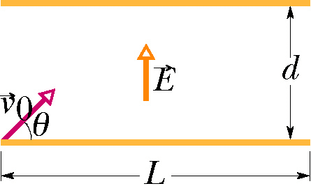

In the figure, a uniform, upward-pointing electric field E of magnitude 5.00E3 N/C has been set up between two horizontal plates by charging the lower plate positively and the upper plate negatively. The plates have length L = 4 cm (0.04 m) and separation d = 2.00 cm (0.02 m). An electron is then shot between the plates from the left edge of the lower plate. The initial velocity v0 of the electron makes an angle θ=45° with the lower plate and has a magnitude of 9.07E6 m/s.
a) Will the electron strike one of the plates? If so, what is the horizontal distance from the left edge? If not enter the vertical position at which the particle leaves the space between the plates ( m).
b) The next electron has an initial velocity which has the same angle θ=45° with the lower plate and has a magnitude of 7.28×106 m/s. Will this electron strike one of the plates? If so, what is the horizontal distance from the left edge? If not enter the vertical position at which the particle leaves the space between the plates ( m).

**This question has been eluding me for a while, and that's probably because I can't wrap my head around the question. The attempt I have up there was given to me by one of my classmates and I've attempted to follow along as you can see, but I don't understand it. Is the attempt, in your opinion, good? Did I do those parts correctly? What does it even mean? Tx and Ty? Please, help me.
I found a comment going through this problem. I've posted that entire comment, editing my data into it and doing the calculations. It didn't work. Please help me figure out where I went wrong.
Attempt 2:
To determine whether or not the electron strikes one of the plates, we need to determine the time Ty required to travel a vertical distance of y = 0.02 m and the time Tx for a horizontal distance of x = 0.04 m.
If Ty < Tx, then the electron will strike the negative plate.
If Ty > Tx, the electron will not strike the plate and we will then determine the vertical distance at which the particle leaves the space between the plates.
For the most part, this is a kinematics problem, but we need to evaluate the vertical acceleration induced on the electron as it travels through the plates.
This acceleration is found by equating F = qE = ma --> a = qE/m
a = qE/m
a=(1.6E-19)(5E3) / (9.11E-31)
a=8.78E14 m/s^2
We also need to isolate the x and y components of the velocity v0.
Vy = v0sin(45) =(9.07E6)(sin45)= 6.41E6 m/s
Vx = Vy = 6.41E6 m/s
Now we find Ty and Tx.
0.02 = 0+(6.41E6)(Ty)+(0.5)(8.78E14)(Ty)^2 --> Ty = 2.64e-9 s
0.04 = 0+(6.41E6)(Tx) --> Tx = 6.24e-9 s
Since Ty < Tx, the electron will in fact strike the plate at a horizontal distance of x = 0+(6.41e6)(2.64e-9) = 0.017 m.
**I entered 0.017 m into the online homework and it said it was not correct. What did I miss?**

rlc said:
solve for the height using time*acceleration
Umm... no.
The first stage was right, finding the time to traverse in the x direction. But the questions asks for the y value on exit, so it is more obvious to plug the time for the traversal into the vertical motion equations to find y. If the answer is negative then it hits the lower plate.
But there is another question that needs to be answered: does it hit the upper plate?
Since Ty < Tx, the electron will strike the plate...right?
But bear in mind it might never reach that height.
Careful with signs! Which is the positive vertical direction?
Isn't Ty the positive vertical direction?
What are the correct signs for the initial vertical velocity and the vertical acceleration?
Are they both negative?
Up in the diagram is positive, yes?
Is the initial vertical velocity up or down?
Is the acceleration up or down?
The initial vertical velocity is up and to the right. Acceleration...that would be affected by the charges, right? The upper plate is negatively charged while the lower plate is positively charged. An electron is negatively charged.
Right, so which way is the acceleration?
Upward as well? Would it be attracted to the negative charge?
Or is it the exact opposite?
Oh wait, it'd be attracted to the positive charge, right?
Do like charges attract or repel?
Like charges repel
Yes.
So what is the sign on the acceleration?
Negative.
Would that affect this equation in this way?:
0.02 = 0+(6.41E6)(Ty) - (0.5)(8.78E14)(Ty)^2
rlc said:
Negative.
Yes.
Likes rlc
0.02 = 0+(6.41E6)(Ty)-(0.5)(8.78E14)(Ty)^2 --> Ty = 4.5183E-9 s
Ty < Tx, so x = 0+(6.41e6)(4.5183E-9) = 0.029 m.
Oh my gosh, thank you! That worked!
Vy = v0sin(45) =(7.28E6)(sin45)= 5.15E6 m/s
Vx = Vy = 5.15E6 m/s
0.02 = 0+(5.15E6)(Ty)-(0.5)(8.78E14)(Ty)^2 --> Ty = ?
**I'm not able to solve this equation. My calculator says that there is no sign change to find the intersection, and otherwise I'm getting imaginary numbers.**
0.04 = 0+(5.15E6)(Tx) --> Tx = 7.77e-9 s
That means that the electron doesn't hit the plate. It can't make that distance.
How do I find the vertical position at which the particle leaves the space between the plates?
=(vt(sinθ))−0.5gt^2
Should I use this equation for displacement?
rlc said:
=(vt(sinθ))−0.5gt^2
g?
Gravity. But for this problem, would it instead be the electric field?
The acceleration due to the electric field, yes.
(1.6E-19)(5.00E3 N/C)=(9.11E-31)a
a=8.78E14
y=(vt(sinθ))−0.5gt^2
y=((5.15E6)(7.77e-9)(sin 45)) - 0.5(8.78E14)(7.77e-9)^2
y=0.00179 m
This is wrong. Do you see what I missed?
I'm guessing it's something concerning the distance from end to end of 0.04 m.
You've already used sin 45 to get the 5.15E6
Likes rlc
  • #31
y=((5.15E6 m/s)(7.77e-9 s)) - 0.5(8.78E14 m/s^2)(7.77e-9 s)^2
y=0.0135 m
I just checked this, and this is the correct answer (! yay!). Why is the 0.04 not involved in this last step like I thought? Is it because it is involved in the calculation for Tx, which is the time we used for this part?
  • #32
Yes.
  • #33
Thank you very much for helping me through this problem. I probably wouldn't have found those mistakes if you hadn't pointed them out to me.
