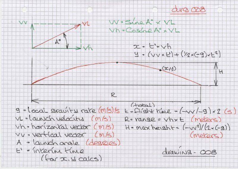

Given that x is horizontal and y is vertical, the starting point is to break the launch velocity into its horizontal vector (x) ( which is deemed to be constant velocity )
and its vertical vector (y) which comes under the influence of gravitational deceleration.
Ive attached a sheet, which won't solve your problem but might give you a start.

The velocity change will only take place in the y direction. Calculate the x component of velocity and the y component after 2 seconds and find their resultant.
Thank you very much that helped Immensely!
