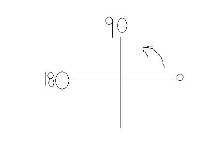

Just to be clear, do you mean when the Θ in your diagram is 10 degrees, you say -10 and they say 100 degrees? I don't think 100 makes any sense at all, -10 makes some. What are you going to do with the angles? If you are going to take the flight of the ball after it bounces, then +10 would be the angle above horizontal that should be entered into the projectile motion formulas. Actually it would have to be 170 if you use the standard that positive x is to the right.
um when i see something like this you always start like
so negative would be going clockwise using the same values in reverse and negatives

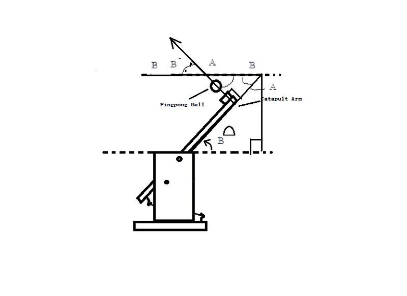

Here is a less ambiguous sketch of our failed catapult and the situation:
http://s872.photobucket.com/albums/ab287/uzzimike86/?action=view&current=FailedCatapult-1.png
Am I incorrect to say that the launch angle is defined as the angle at which the object is projected at with respect to the horizon, and that it is not the angle at which the catapult arm makes with the horizon?
It appears as if they are referring to Θ as our launch angle, whereas I am saying that alpha is our launch angle. It seems to me that they are not referring to the launch angle at all - they are referring to the angle at which the arm makes with the horizon at the point of launch.
Sketch of a conventionally constructed catapult for reference:
http://s872.photobucket.com/albums/ab287/uzzimike86/?action=view&current=NormalCatapult.png
[Given the same conditions where Θ is angle that my team argues for as the launch angle and alpha being the angle that I claim is the launch angle.]
As we can see from the diagram (maybe not) and using elementary geometry concepts, Θ does not equal alpha (except at 45 degrees).
When one studies projectile motion and you are given a problem involving an angle, range, initial velocity, etc, the angle given as the launch angle is not Θ - it is alpha.
Now let's go back to the diagram of our failed catapult and use the same logic as that in the diagram of a conventional catapult.
If Θ is 85 degrees, alpha would be 5 degrees. If Θ is 100 degrees, alpha would be -10 degrees. If Θ is 115 degrees, alpha would be -25 degrees. The last two would be required to be negative angles in order to discern a difference between being launched downward at 10 degrees and being launch upward at 10 degrees, correct?

From what I can see, you are almost definitely correct. The launch angle, as far as projectile motion is concerned, is the angle between the projectile velocity vector and the horizontal ( [tex]\alpha[/tex] in your diagram).

They're related, but they aren't equal. They're complementary. [tex]\alpha + \theta = 90\deg[/tex] This can be seen in your diagram too - look at the one I just uploaded.

I get alpha = θ - 90
When alpha is 100 degrees, θ = 10 degrees. The 10 degrees is below horizontal as your alpha indicates.

lol i shouldn't try to do this stuff at 1 am... i re did it with a few extra triangles and yes
alpha+theta = 90... my bad. Even without the triangles you can extend the alpha line to get a singular right angle triangle incorporating both alpha and theta
