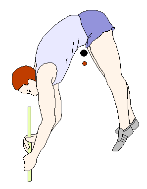

A pole-vaulter is limited fundamentally by his forward speed. So his bar height sets a lower bound on his speed. Same for this ballistic motorcyclist and his downrange distance (ignoring air) .
So I think this data could in fact show that the cyclist must have been speeding. It cannot show definitively that he was not speeding
