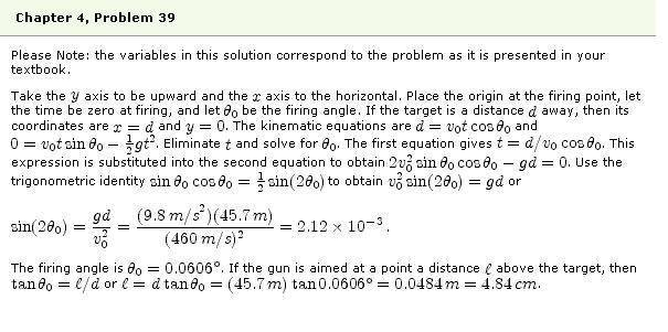

OK so possibly it is the book that's wrong and not me because using that equation I got y=4.905cm but the answer online is
Number 5.056439020552 Units cm
I also used the books solution which is
and using my numbers I still get the 4.905 so I am pretty confused
well nevermind I worked it out again and got the right answer still don't really understand the solution though
