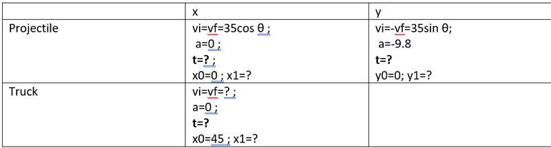

At first I thought that I can assume that the project tile hits the truck right at the position where y=0. My equation was:
##y-y_0=v_{0y}t+(\frac 1 2)at^2=0 ##
##t= \frac {-v_{0y} *2} {a} ##
##t= \frac {-35sin(23)*2} {-9.8} ##
##t=2.79 ##

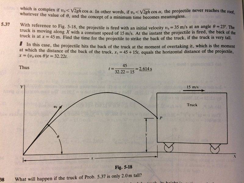

The key is 2.614, which is less than 2.79, which means the projectile strikes the truck before it reaches the ground. The time it takes for the projectile to land the ground (and complete the curve) is greater than the time it takes to hit the truck, as the diagram indicate.
My 1st question: How can I be sure that it is so? What does the key mean by saying "at the moment of overtaking it"? I was stuck on the way I formulate an equation for the time, which was this.
## t_{time taken to strike truck}=t_{time taken for Δy=0} - t_{?? not sure how to determine} ##
It seems like I have an ineffective way of thinking through this problem, and I'm curious on what are better ways.
Unfortunately, it took me a long time (20 minutes for this one) to brainstorm the solution even though on tests I'm supposed to solve them in 3-5 minutes. I understand the concept of projectile motion, but cannot apply to problems. How can I be faster? I tried several methods including re-drawing the diagrams and putting variables in a table like below.
My 2nd question : how to improve in general problem-solving in physics, specifically problems about kinematics. Thank you!
Why assume that?
What matters is that the projectile has to catch up with the truck. That means the projectile and the back of the truck must be at the same position along the x-axis. (Thus the horizontal motion is key!)

Ask yourself. Does it matter how high the projectile reaches? yes or no answer.
Likes Beth N
You can compute how long it takes for the projectile to hit the truck and compare it to the time it would take the projectile to land. To assume delta y = 0 is not motivated. Anybody who got their windshield destroyed due to stone chips flying off the road should be able to testify to that.
In fact, you should also be able to compute where it hits.

The vertical motion of the projectile is irrelevant. [Re-read the OP -- the truck is "very tall"]. The horizontal motion of the projectile plotted as horizontal distance versus time is a straight-line graph. The position of the back of the truck plotted as horizontal distance versus time is also a straight line graph.

Those are not curves of distance vs time, they are curves of height vs distance (in which the truck is just a horizontal line).
The only relevance of the vertical motion is to confirm that the projectile is above ground at the point it overtakes the truck. If you solve for the height of the projectile at that point and the value is negative, that means that the projectile hit the ground before it could overtake the truck. :wink:

Ok back to the figure the y-axis is the height of the projectile and truck relative to ground respectively. The x-axis is the horizontal distance covered by the projectile and truck. I don’t see an indicator for tallness but the the point “p” is an arbitrary height as shown on the diagram. Since this point looks midway, the tallness of the truck would be 2p So the problem appears to really be when does the projectile reach the height “p” for a truck gaining horizontal distance from the projectile. So for question #1 the assumption is the projectile is gaining horizontal distance to the right faster than the truck is moving in the same direction, Using your answer graph the truck and projectile and see if projectile is at the same point in horizontal distance. That will help you test your answer. Assuming the projectile is moving faster than the truck the instance in time when the projectile is equal to the height p and the same horizontal distance as the truck will be the point the projectile will overtake the truck. I think you need to look at the truck as a constraint equation to solve the problem
Since "p" is unknown, that won't help solve the problem. The correct way to approach the problem, as discussed above, is to first concentrate on the horizontal motion. Only after you've solved for when the projectile overtakes the truck would you even worry about the projectile's height "p".
