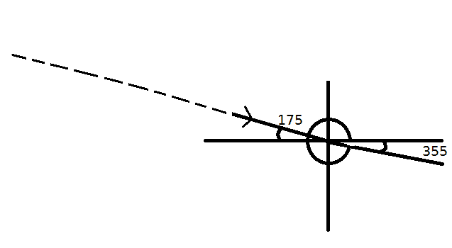

In summary, a projectile is fired horizontally from a gun 55.0 m above flat ground with a speed of 350 m/s. After calculating for various parameters, it can be determined that the projectile remains in the air for 3.35 seconds, strikes the ground at a horizontal distance of 1190 m, has a y-component velocity of -33.32 m/s, a magnitude of speed of 351.6 m/s, and an angle of -5 degrees when it hits the ground. However, it is more common to use the angle of 175 degrees as it is the smaller angle with the surface.

So I attempted each one and just want feed back on my answers.
a)t=3.4s
b)x=1190m
c)-33.32m/s
d)351.6m/s
e)355 degrees
Your method is correct, but.
1. The precision of the time result is rather low, so some of the significant digits in the subsequent results are incorrect.
2. 355 degrees cannot be an angle with which the projectile strikes the ground, because this is underground. The angle must be less than 90 degrees.
So the timing is incorrect?
This is what I did...
y=(350m/sin(0))t-0.5gt^2
-55m=-0.5(9.8m/s^2)t^2
-55m/-4.9m/s^2=t^2
t=3.35s so I rounded it to 3.4s
Not necessarily.
So instead of adding 360 degrees, I should have added 180 degrees?
Im not sure of you question. Adding 360 to 355 would get you to 355 again, you would make a complete circle. If I have interpreted your answer correctly, 355 into the ground, equals 175 above y axis. I have not worked the problem though.
3.35 s is better.
For an angle with a surface, one may may always choose either an angle greater than 90, or less than 90. Usually the smaller angle is selected.
Okay so I took the tanarc(-33.32/350) and got -5 degrees... Then I added 360 to get 355 degrees... So I would add 180 degrees instead of 355 because 355 degrees would be the angle it penetrates the ground? and 175 degrees would be the angle at which the projectile hit the ground?
