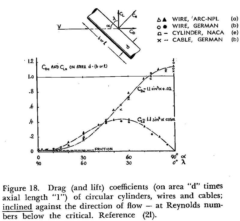

I suggest two simplifying assumptions:
1) It travels in a straight line (no torque to the right).
2) The drag is an average of the drag for a tumbling cylinder.
This drag plot is from Fluid-Dynamic Drag by Hoerner:
Based on this plot, I would try a drag coefficient of 0.6 with drag area 7.75" by 59" for the first calculation for the center of your search area. Then bracket it using drag coefficients of 0.5 and 0.7 to get an estimated diameter for the search area.
