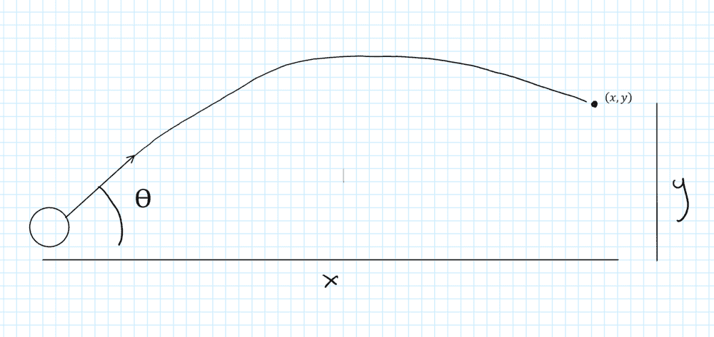

Create a general equation to find the initial velocity of the ball such that it hits the target (x, y). Include air drag.
Variables known:
Launch angle (Theta)
Distance to target (x and y)
Drag coefficient of sphere (.47)
None
Tell me now if this question is posted in the wrong place. This isn't a homework problem per se, it's just a question I need answered and I'm not sure how to answer it. If there is any information missing, chances are I know it and forgot to post it, so please ask if something is missing.
I drew out the situation in the attachment below. I can only solve this problem without air drag, I'm lost as to how to add air drag to it.

Hello trumanf, :welcome: !
You are in the right forum !
However, the 'None' under homework equations doesn't cut the cake: you'll need some !
Note that the exercise doesn't ask you to solve the equation, just to set it up.
