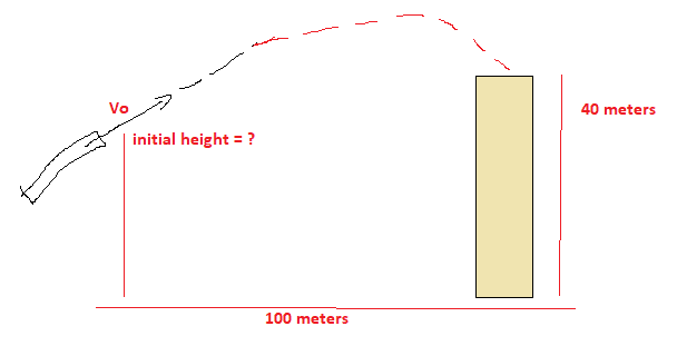

I am given a problem where a 6kg object is launched from a cannon from an unknown initial height and eventually lands on top of a platform that is at a height of 40 meters above the ground. As you can see from the diagram, the final height is greater than the initial height.
The total displacement in the x-direction is 100 meters, and the object is launched from an angle of 25 degrees with an initial velocity of 5 m/s. I am asked to find the initial height at which the object is launched.
y=y0+vy0(t)-1/2gt^2,x=x0+vx0(t),v=v0+at, vy^2 = vy0^2-2g*change in y
First, I tried solving for the total time of flight, which I got as 100 = 5cos25*t --> t=22 s
Since we know the height at which the object lands, but not at which it is launched, I tried setting up the equation as:
yf = 40 - y0 = y0 + 5sin25*(22) - 1/2(9.8)(22)^2
However, I got y0 = 1183 m, which is not realistic given the problem statement. I assume this equation works if we only have freefall from an initial height.
I then tried solving for the the height at which vy = 0 (at max height):
0^2 = (5sin25)^2-2*9.8*deltay
delta y = 0.23 m
I also tried vy = v0y - gt for vy = 0 and got t = 0.22 s.
I don't know where to proceed from there. I also don't know if we need to change the sign of acceleration due to gravity when we consider motion past the point of maximum height.

Do you think you can hit a target 100m away by launching a projectile at 5m/s?
What would be the approach to solving the problem if the target were not as far away?

You could try with ##v_0 = 50m/s##.
With v0 = 50 m/s, I get y0 = 973 m, which still doesn't meet the criterion that y0 < yf.

That is definitely not right. What's your time of flight?

Oops...I used the same time of flight as for the previous problem.
The new time is 100 = 50cos25 * t ---> t = 2.2 s
So, 40 - y0 = y0 + 50sin25*2.2 - 1/2(9.8)(2.2)^2 --> y0 = 8.6 m
