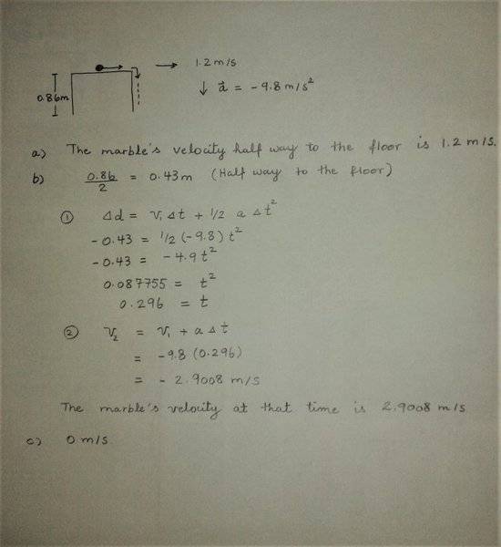

Hey Guys, I have attempted the question below and need someone to check my work, please.
Thanks!
1. Homework Statement
A marble rolls off a desk that is 0.86 m above the floor with a horizontal speed of 1.2 m/s.
a) What is the marble's horizontal velocity when it is half way to the floor?
b) What is the marble's vertical velocity at that point?
c) Describe the value of the vertical component of velocity as the marble falls to the floor.​
For c), I don't think that ##0## is the answer they are looking for!
Also, if you are using ##g## to one decimal place, you cannot have an answer for velocity to four decimal places.
Likes aatari
Will it be 2.9008 m/s?
It is not correct to write ##\vec g = - 9.8 m/s^2## , because a vector is never equal to a number.
After the ball leaves the table, the vertical component of its speed increases from ##9.8 m/s## to every second until it collides with the ground.
No, you just do what you did to find its velocity half way to the floor.
You can safely ignore post #5.
Likes aatari
I get it, thank you.
It will be 4.1 m/s.
It will be 4.1 m/s.
That looks about right.
Likes aatari
It will be 4.1 m/s.
In letter c he does not ask for speed by hitting the ground. He asks what happens to the speed over the fall.
Good point.
For this, see post # 5 "ignored".
It will be 4.1 m/s.
It looks like they weren't asking for the speed as it hits the floor, but a "description of the value" during the fall.
Exactly
The thing to ignore was about the vector. The OP's diagram is good and clear in its vector representation, in my opinion.
The problem is that he wrote ##\vec g= - 9.8 m/s^2##
The correct is ##\vec g= -9.8 \vec j m/s^2## (vector equation) or else I could write ##g=-9.8 m/s^2## (scalar equation)
