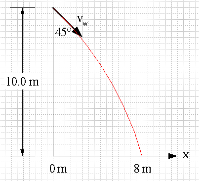

I set up a triangle which has the 10.0 meter fence as the y-axis and the 8.0 meter distance as the x-axis and the balls path is the hypotenuse in between. I do have those distances but without any form of time i still can't calculate anything from that triangle i don't think. And the Vy,f is the final velocity correct? which means that it would simply be zero, leaving me with 0 = -4.9t2
The ball's path won't be a straight line: It follows a parabolic trajectory due to the influence of gravity.
You've recognized the problem within the problem, namely the trajectory from the top of the wall to the ground:
If you assume some speed for the ball at the top of the wall, say vw, and the projectile is moving at 45° below the horizontal from the top of the wall, and you know that it strikes the ground at 8 m from the wall, can you determine the speed vw?
You should be able to write equations of motion for the x and y directions, and write the initial velocities in the x and y directions in terms of vw (sin(45°) and cos(45°) have simple values). There's enough information to find vw.
Once you know the speed vw at the top of the wall you should be able to find the impact speed at the ground.

Write the kinematic equations for the x and y components of the motion from the top of the wall. Assuming an initial speed vw, what are the x and y positions of the object with respect to time?
Ive used the Vx=Vcosθ and Vy=Vsinθ ( where θ = 45) yet all i get from both of those is 0.7071V. You mention in respect to time and i assume that i am misinterpreting what you mean to convey, as there is no time as of right now in my equations and problem.
Write the kinematic equations of the motion! y(t) = ..., x(t) = ...
Yes, you are introducing a time variable t, but you will soon get rid of it by combining the equations. So, just start by writing the equations of motion. You want to solve for the initial velocity at the top of the wall that results in the projectile striking the ground 8 m from the base of the wall. You have enough information given: the launch angle, initial height, and horizontal distance at the point of impact.

y(t) means y as a function of t, x(t) means x as a function of t.
From the assumed initial speed and given launch angle you can write the initial x and y velocity components. Then you can write the equations for the x position and y position with respect to time using those initial velocities. Those are the basic projectile motion equations.
So, write the equation for the y position given the initial y-position, initial y-velocity and the known acceleration due to gravity. Also write the x-position given the initial x-position and x-velocity (assume that the wall is at x position 0 m).
math notation writes "f, as a function of x" like f(x).
physics folks sometimes use math notation, but more often use subscripts, like your vf ... final is a time, after all.
Almost always, we use x as horizontal; for vertical we either use y or z.
Notice that your "d" equation has an acceleration ... if the acceleration is NOT zero, which direction is it? (x or y) ... call it that (dx or dy)
If the acceleration IS zero, which direction is it? (x or y) ... call it that (dx , or dy)
Now, solve the simpler equation for "t" ... and plug it (that symbolic formula) into the nastier equation.

ok that makes some sense to me, so the y(t) = ..., x(t) = ... gneill was talking about refers to dx =...and dy =... equations? such as dy = vi • t + 0.5 • a • t2
And i am assuming that the "nastier equation" is referring to the formula that i create to cancel out a variable that i don't have yet?
The d equation with acceleration is the dy (vertical) as it is gravity that acts upon it. and the one without acceleration (=0) is horizontal.
yeah, go for it! by coincidence, in this problem the vx = -vy , only as the ball crosses the fence
... for the vertical one vfence,y =/= vground,y
Ok well ill give it a shot tomorrow and post back on here if I've gotten it or not.
Ok so i understand what you mean about vx=-vy, so with this being said i should be able to take dx/t = the rearranged formula for dy=vit+1/2at2, my only issue is that it doesn't work out. I am assuming that I am rearranging something wrong or my logic is flawed.
