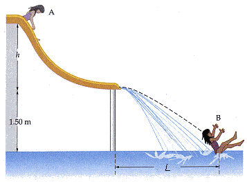

Projectiles and conservation of energy (water slide problem)
In summary, the problem involves a person sliding down a frictionless water slide and landing in a pool. The task is to find the height of the slide, given that the person starts from rest at a height of 1.50 m and lands at a horizontal distance of 2.58 m from the base of the slide. Using the conservation of mechanical energy theorem and the kinematic equations, the height of the slide can be calculated by linking the energy and projectile portions of the problem.

The water slide shown in the figure ends at a height of 1.50 m above the pool. If the person starts from rest at point A and lands in the water at point B, which has a horizontal distance L = 2.58 m from the base of the slide, what is the height h of the water slide? (Assume the water slide is frictionless.)
PEi+KEi+W=PEf+KEf
PE=mgh
KE=(1/2)mv2
Vertical displacement after leaving slide: Dy=vot+(1/2)at2
Horizontal displacement after leaving slide Dx=vft
PEi+KEi+W=PEf+KEf
PEi=KEf
mghi=(.5)mvf2
(9.81)h=(.5)vf2
I'm not really sure where to go from here. Any help would be greatly appreciated.
Thanks,
Will
well v would be v=√(2gh).
It looks like the person leaves the slide horizontally. Use the kinematic equations, you are given the range L.
First let's consider the energy part of the problem by setting up an coordinate frame such that y=0 at the bottom of the slide. From this you can apply the conservation of mechanical energry theorm PE1+KE1=PE2+KE2 which will result in PE1=KE2. This is because we defined y=0 at the base of the slide and thus PE2=0 with respect to that frame. Now let's look at the projectile part of the problem. We know how far the person traveled in the 1.5m from the ground to the base of the slide, and we can calcualte the time it takes an object to fall 1.5 under the influence of gravity. So we know distance in the x direction and the time it took to travel that distance, thus we know our x velocity Vx. Last we link the energy and projectile portions of the problem to obtain a solution. We can now do this because we know KE2 since we calculated that velocity Vx. If we know KE2 we know the potential energy PE1 at the top of the slide and thus the height.
Also note that work W should not appear in the conservation of mechanical energy equation. If you were referring to Wg the work due to gravity you doubled down on that term since Wg is already accounted for in terms of potential energy in the conservation of mechanical energy equation.
