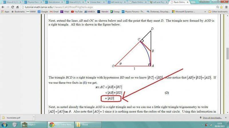

Dear PF Forum,
Continuing our debate discussion in differential in slice of X.
I read this particulare website. About proofing the derivative of sine(x).
http://tutorial.math.lamar.edu/Classes/CalcI/ProofTrigDeriv.aspx
In there, the web writes
Code:
arc AC < |AB| + |BC|
       < |AB| + |BD|
       = |AD|
I don't know what the "equal sign" means.
Is this?
A:
Code:
arc AC < |AB| + |BD|
arc AC = |AD|
or this?
B:
Code:
arc AC < |AB| + |BD|, where |AB| + |BD| = |AD|

Your first interpretation is correct. Get used to that kind of terse writing, it's pretty common.
Which one?
This?
A:
arc AC = |AD|,
but arc AC can't be |AD|. This is my instinct. I just one to know exactly what it means, because in math, a little misinterpretation can lead to big mistake, more with "proof"
Stephanus said:
Which one?
This?
A:
arc AC = |AD|
Yep.
Moderator note: The answer above is wrong.
Ok, I understand now.
I read subsequent paragraphs, it's just the way this website formats its answer.
It is.

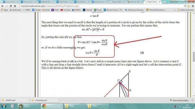

Weird?
You should see this:
This should be arranged to
##\theta = \text{arc AC}##
##\tan\theta = \frac{\sin \theta}{\cos\theta}##
then
##\text{arc AC} < \tan \theta## or
##\text{arc AC} < \frac{\sin \theta}{\cos \theta}## or
##\theta < \tan \theta## or
##\theta < \frac{\sin \theta}{\cos \theta}##
And the web simply writes
##\theta = \text {arc AC} < \tan \theta = \frac{\sin \theta}{\cos \theta}##

Actually, I would prefer what was written on the website in that case :P
Seems much more succint in my opinion.
NO! The second version is the correct one, not the first.
Version B says this:
arc AC < |AB| + |BC| < |AB| + |BD| = |AD|
In short, arc AC < |AD|
Likes Stephanus

Stephanus said:
Code:
       < |AB| + |BD|
       = |AD|
Is this?
A:
arc AC = |AD|
As already discussed, no, this is not the same as what's at the top here. Notice that at the top, "arc AC" appears only once, not three times, as you have it just above.
Mixing inequality symbols with equal signs is very common in math texts. For a chain of expressions like this one --
Code:
       < |AB| + |BD|
       = |AD|
-- the < sign on the 2nd line refers back to the right side of the previous line. The = sign on the 3rd line refers to the previous (2nd) line.

Hmmm, it's not the proof that I'm asking. It's just how the web format it's output. But through lengthy equation the proof is
##\cos \theta < \frac{\sin \theta}{\theta} < 1##.
So, using layman term. if we 'boost' theta to zero, it will be
##\cos zero < \frac{\sin \theta}{\theta} < 1##, cos zero as we all know is 1.
##1 < \frac{\sin \theta}{\theta} < 1##, so, in tecnical language. ##\frac{\sin \theta}{\theta } = 1!## (btw the exclamation mark is not factorial it's just exclamation mark! :smile:)
NO! ##\frac{\sin \theta}{\theta } \neq 1##
But ##\lim_{\theta \to 0} \frac{\sin \theta}{\theta } = 1##
We don't "boost" ##\theta## to zero; we take the limit of each term as ##\theta## approaches zero.
Stephanus said:
But that's not the proof that I ask.
It's:
why the website write its format like this.
< |AB| + |BD|
= |AD|,
It's the equal sign that I want to know. But I already know the answer, when I read subsequence paragraphs. It's just how the web format its output.
I thought I had answered this question earlier, but apparently you didn't get what I said. It is common in mathematics and physics textbooks to connect multiple expressions using inequality symbols and equal signs. The above is exactly the same as writing this:
arc AC < |AB| + |BC| < |AB| + |BD| = |AD|.
One could write this as a sequence of inequalities and equations, like so:
|AB| + |BD| = |AD|
Writing these inequaliies/equations like this takes up more room, and makes it harder to see the main point: that arc AC < |AD|.
In a compound expression using inequalities and equals, the same type of inequality has to be used throughout -- you can't mix in < signs with > signs.
|AB| + |BD| = |AD|
Come on, Mark44.
I have already had the answers days ago, but for several post, members weren't answering my question. They discuss the proof of sine x.
Which is not what I asked. I just asked why the format is
< |AB| + |BD|
= |AD|
And for this I have already had the answer days before. Perhaps my title is misleading.
The answer is, as you wrote,
|AB| + |BD| = |AD|
The web should write like that to avoid misunderstanding.
And for proof of sine x...?
Well, I have learned the proof also.
See this equation.
##\cos \theta \lt \frac{\sin \theta}{\theta} \lt 1##
or I could write
##\cos \theta \lt X \lt 1##
Than, if we boost theta to zero, than ##\cos \theta## must be 1. So
##1 \lt X \lt 1##, even if this is not the correct mathematic formula. Technically, X is squeezed between 1 and 1, so I'm convinced that X is none other than 1.
So ##\frac{\sin \theta}{\theta} = 1## if theta is almost zero.
But we all had this concept in high school, right. Just forgot the proof. Now I see the proof clearly.
or I could write
How big is "almost zero"? Is .00001 almost zero? If so, ##\frac{\sin \theta}{\theta}## still isn't equal to zero.
As long as ##\theta## is different from zero, ##\frac{\sin \theta}{\theta}## will be different from 1. What we can say, though, is ##\lim_{\theta \to 0}\frac{\sin \theta}{\theta} = 1##. IOW, the limit of this fraction is 1, even though ##\frac{\sin \theta}{\theta}## is never equal to 1 for any nonzero value of ##\theta##.

For those who can answer my question (especially you Micromass :smile:) don't need this picture. But I show it anyway, so we are at the same prespective.
So through a lengthy calculations we come up at this
Now theta could be as low as 0 and as high as 1/2 pi.
when theta is 1/2 pi there are range of possibility for ##\frac{\sin \theta}{\theta}##. It's in the range between 0 and 1. Altough we all know the answer for ##\theta = \frac{1}{2} \pi## is ##\frac{\sin \frac{1}{2}\pi}{\frac{1}{2} \pi} = \frac{2}{\pi} ##
theta = 1/3 pi, the range for ##\frac{\sin \theta}{\theta}## at quick glance is between ##0.5 \text{ to } 1##. Answer: ##\frac{3\sqrt{3}}{2\pi}##
theta = 1/4 pi, range is ##\frac{1}{2}\sqrt{2} \text{ to } 1##. Answer: ##\frac{2\sqrt{2}}{\pi}##
theta ≈ 0, range is ##≈1 \to 1##, so deducting by this logic. ##\frac{\sin \theta}{\theta}## is 1 if theta is almost zero.
Is this the wrong way to think?

Yes, it's the wrong way to think.
##\frac{\sin \theta}{\theta}## is undefined if ##\theta## = 0, and if ##\theta## is near zero, ##\frac{\sin \theta}{\theta}## will be only near 1, but won't be equal to 1. So it's incorrect to say "##\frac{\sin \theta}{\theta}## = 1" or "##\frac{\sin \theta}{\theta}## is 1" if ##\theta## is "almost zero." No matter how close ##\theta## is to 0, ##\frac{\sin \theta}{\theta} \neq 1##.
That's where the concept of the limit comes in. It is correct to say ##\lim_{\theta \to 0} \frac{\sin \theta}{\theta} = 1##, with an emphasis on the limit part.
Likes Stephanus
