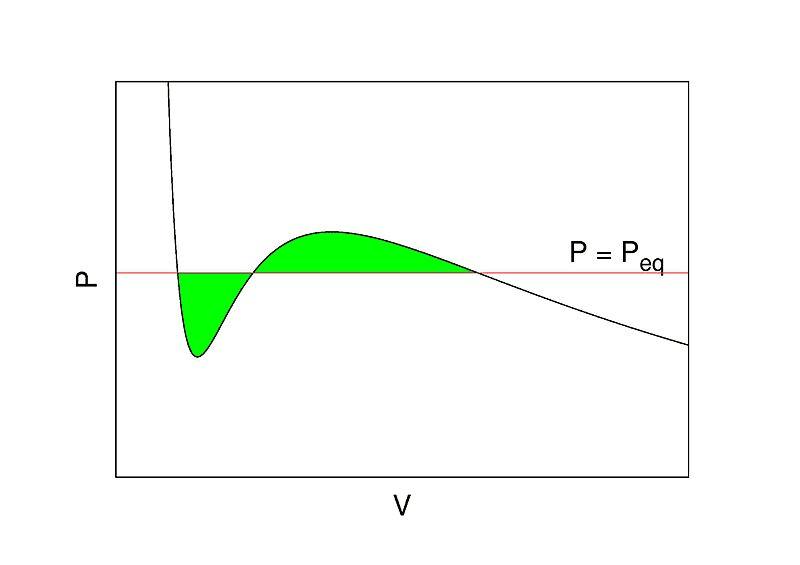

Actually, after further inquiring about the subject ( I asked a professor teaching statistical physics course ), he told me that the Van-Der-Waals gas is a model characterized by both first order and second order phase transitions, explanation:
The gas describes a first order phase transition because if for example we plot P(v) , we'll get something like this:
in the green-shaded area, the following stability-criteria does not hold:
## - \frac{\partial p}{\partial V}>0 ##
( This stability criteria appears in "Thermodynamics and introduction to Thermostatistics - Callen" )
Since the stability-criteria does not hold then we say there is a "jump" of P(v) in the green-shaded area and we have to insert Maxwell-construction model to describe the system's process in the green area.

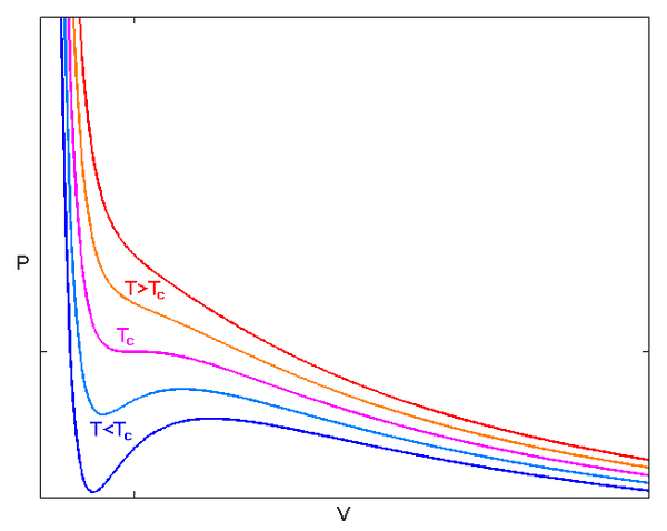

However, The gas also describes a second order phase transition for a specific type of isotherm - this isotherm describes a temperature called "Critical Temperature" ( also denoted as Tc ), and if we plot P(v) for this isotherm, we'll see that P(v) has stability-criteria fulfilled for all V , but there is a single point in which P(v) has an inflection point - this is the critical point in which the first and second derivatives are zeros ( since this is an inflection point ):
## \frac{\partial p}{\partial V} = \frac{\partial^2 p}{\partial V^2} =0 ##
Conclusion: VDW gas desribes mostly a first-order phase transition except for a specific isotherm ( Tc) for which the gas describes only a second order phase transition.

What if ##T>T_c##?
TeethWhitener said:
What if ##T>T_c##?
If T>T_c then there is no phase transition since once we have reached T=T_c and went to higher temperature - our VDW model already passed from one phase into another.
So for T>T_c then P(v) describes only one specific phase and no phase transitions since the stability criteria
Is satisfied - so there are no discontinuities which would indicate a first-order phase transition and also there are no inflection points which would indicate a second-order phase transition, so P(v) only describes the relationship between P and V for the one particular phase we are currently in for T>T_c.
Likes TeethWhitener
Yes. The important point is that it is the Maxwell construction (and not the vdW equation of state by itself) that generates the 1st order phase transition for ##T<T_c##.
One other minor thing: The ##T<T_c## isotherms also have inflection points, where ##\frac{\partial^2 p}{\partial V^2} = 0##, but it's only at ##T=T_c## that we have a point where ##\frac{\partial p}{\partial V} =\frac{\partial^2 p}{\partial V^2} = 0##.
Edit: to be perfectly honest, I'm not sure you can call the point at ##T=T_c## a second order phase transition. ##\frac{\partial^2 p}{\partial V^2}## is zero, not discontinuous. And all higher derivatives are zero as well. Without the Maxwell construction, the function is smooth (infinitely differentiable) everywhere it's defined. I don't know; I'll have to think harder about it.
