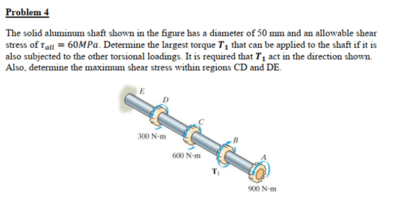

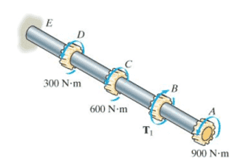

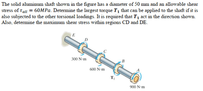

Draw a FBD, determine the largest torque, T1, and find shear stresses in CD and DE
Method of sections, static equilibrium
shear stress=Tc/J

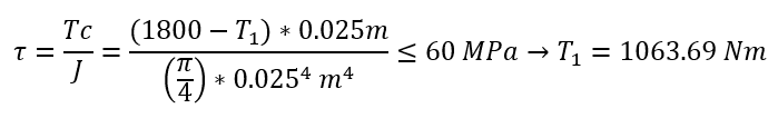

I wish to draw a proper free-body diagram for this shaft. However, my FBD does not agree with the solutions manual. If someone could point out where I erred, that would be great.

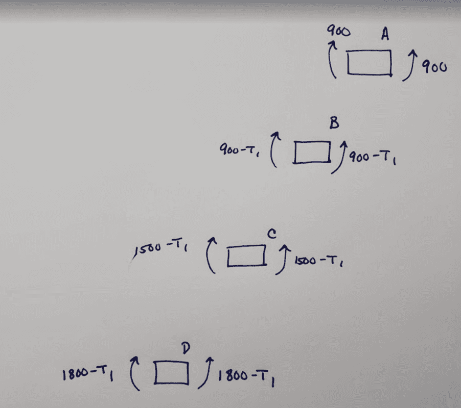

This is what I drew:
From my FBD, it is clear that the maximum torque is present in section DE of the shaft.

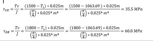

We can use the equation shear stress=Tc/J in conjunction with the maximum allowed shear stress of 60 MPa as follows:
Then, to find the maximum shear stresses in sections CD and DE:

Are you sure about the ##\frac{\pi}4##s? I thought it was ##\frac{\pi}2##
Likes Qube
Thanks! You are right, it is J=pi*c^4/2. I will rework this problem and see if I get the right answer this time...
Note that with your original calculation the 900Nm was already too much for AB.
Likes Qube

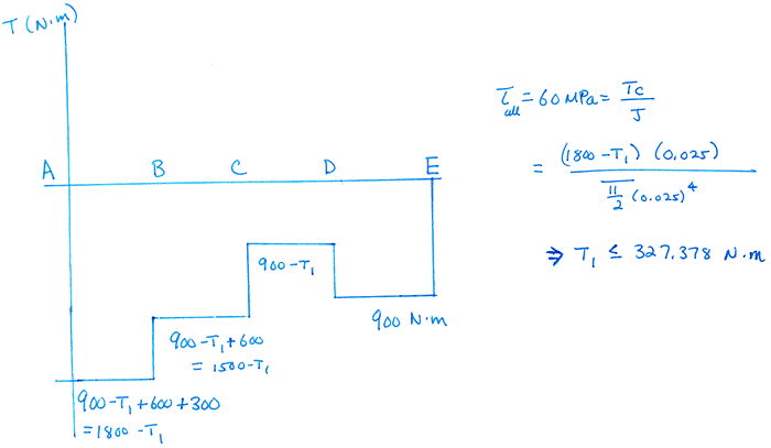

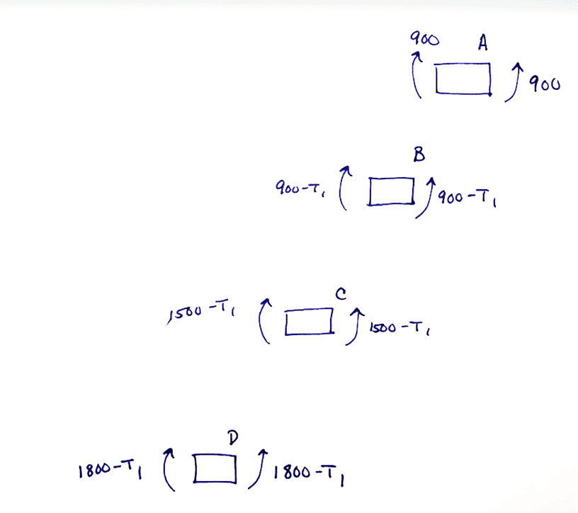

Okay, I reworked the problem. I drew a torque diagram.

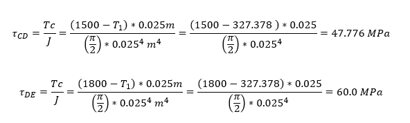

It seems that the maximum possible value of the unknown torque, T1, is 327 Nm.
From there, it seems that the internal shear stress in section CD is about 47 MPa, and the internal torque in DE causes the bar to hit its shear stress limit, 60 MPa.
This makes much more sense than my initial results.
Does it make sense that the section with the highest shear stress is the section of the bar closest to the wall, to which the bar is anchored?

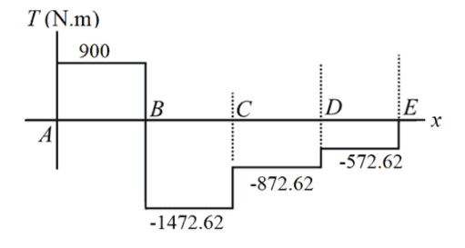

Also, does my torque diagram make sense? Someone else argues that this is the correct diagram:

What, exactly, is the inequality involving 1800 - T1 that you deduce from your diagram?
What will happen to your diagram if T1 is increased a little?
What would happen if T1 were zero?

That's unnecessarily rewriting what you did successfully in post #5 by other means.
You found that the torques are, taking some sign convention, 900, 900-T, 1500-T, 1800-T.
The constraint is some maximum magnitude torque, Tmax. What is the correct way to write that algebraically?

No, I am asking how you express in algebra that, e.g., the torque 1500-T must not exceed the calculated limit (call it Tmax)? Be careful.
1500-T<Tmax
I'm still unclear on what you mean, sorry.
haruspex said:
It's magnitudes!
I don't see a direct constraint on Tmax in this problem that is given. I'm still unclear on what you mean by:
The only constraint I see is on torsional shear, which is a function of Tmax.
I was using Tmax to mean the maximum torsional shear, not the max value of T1.
I'll stop trying to be subtle. You computed 900-T1, 1500-T1, and 1800-T1, and took the constraint to be that each < Tmax. In fact, the constraint is on the magnitudes of these: |900-T1|<Tmax, |1500-T1|<Tmax, and |1800-T1|<Tmax. That opens up more possibilities.
