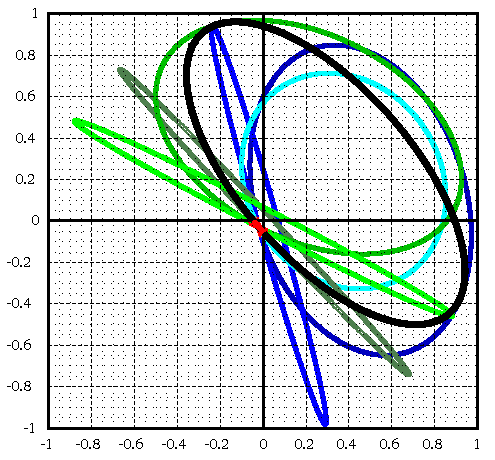

Imagine a unit sphere in space that is initially aligned with a universal xyz coodinate axis. The coordinate axis are attached to the sphere at the six fixed points (+/-1,0,0) (0,+/-1,0) and (0,0,+/-1). The sphere starts rotating around each axis. The six points are now at new points in the universal frame. In real life, these 6 points will transverse a unique path through space.
In trying to predict this path, I have created a model to iterate in each axis. But, I am seeing that the path depends on the order I calculate the axis rotation. I see six possible iteration orders : XYZ, YXZ, XZY, YZX, ZXY ans ZYX. The paths are similar, but not the same and eventually vary widely. To be clear, after every iteration, 2 of the 3 axis change directions, like you expect to happen to the 'local axis' in a space ship, but subsequent rotation will happen around the new axis position.
How can one predict the unique path the 6 points will take? I can only account for one axis at a time here. When I look at each iteration closely, the change in position seem to follow the expect path, its just that the final point after each complete set of iterations is different - depending on the order.

Digging deeper into the problem, here is a follow-up on what I learned.
As expected, when I decreased the iteration interval, all 6 possible orders of iteration gravitated to a single path, although you could still see differences in the actual numbers if you looked out to enough digits.
Here is a rather extreme example to show the different paths. I put together this plot to evaluate the differences. This is a path the sphere would travel if left spinning on the floor, starting out at the red point. Each colored plot is the path taken for each possible iteration order, the black path the one each drifted to when reducing the iteration size.
I would call this an analytical solution. However, was able to find a theoretical way to derive the path. If I evaluated the velocity at each point on the sphere, the velocity for each point rotates about a single axis (as suggested). Further, this axis of rotation of the sphere would be at right angles to the plane containing the velocity vector.
So, finding the velocity vector at two points, then taking the cross-product of these two vectors, provided a means to get to the rotational axis. (Taking the cross product of two vectors produces a vector that is perpendicular to both of the vectors, regardless if the first two vectors are orthogonal or not).
To find the rotation rate about this rotational axis was just a matter of evaluating the speed of the points on the unit circle centered at the origin in the plane perpendicular to this net rotational axis. This produced the path that all the different orders of iteration gravitated towards (the plot above).
