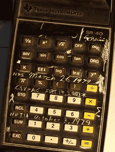

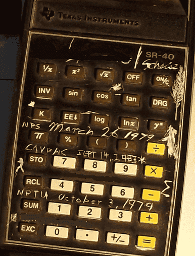

ps. My 40 year anniversary of graduating from Nuclear Power School(NPS) is coming up.
I should celebrate.
Cool. I used to live next door to the KAPL training prototypes in West Milton, NY. Did you go there?
I've never been to New York, so, no.
I went to, ummm... Idaho?
