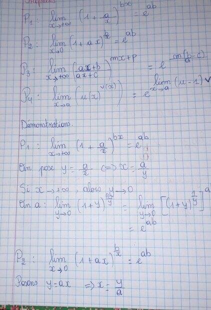

Prove the following properties (in pictures)
Using the def. Of natural logarithm
I did only the the first three prop.
And on a means we have, on pose or posons means let there be , propriétés means properties, alors meand then.
I apologize i am a french native speaker and i am busy so i cannot rewrite this in entirely english

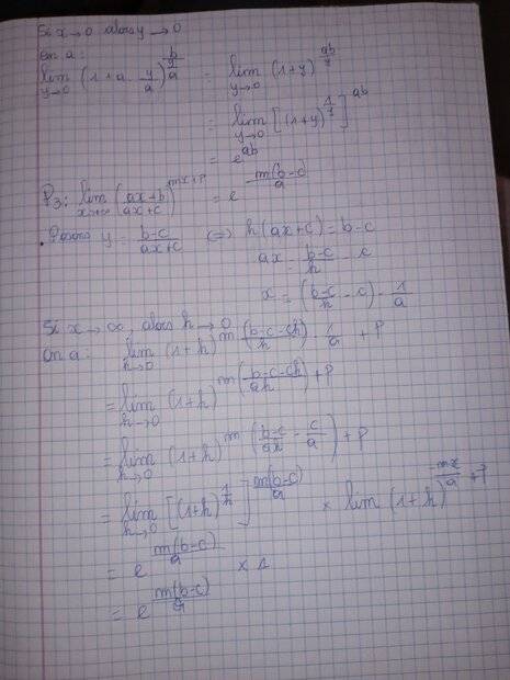

I'm not convinced by what you have done for P1. Where did you use the properties of the natural logarithm?
In any case, you need to be clear about what you are assuming in your proof.
My guess is you are allowed to use

The others are done similarly. Your task is to manipulate the limit to look like (1).
Be careful with statements like if ##x\to 0##, then ##y:= \frac{a}{x}\to \infty\ (a>0)##. This is true assuming ##x\to 0+##. It's clear ##a,b## are some fixed constants, but specify whether they are negative/non-negative. These details are important.

I don't know how to do P4. But i proved all of the first three

I didn't find P4 . Could you explain it to me?
What is assumed of ##u## and ##v##? Details are important! Do you seek to prove
[tex]
\lim _{x\to a} u(x) ^{v(x)} = \exp \left ( \lim _{x\to a} (u(x)-1)v(x) \right )?
[/tex]
If so, then don't bother, for this is false.
It is true that
[tex]
\lim _{x\to a} u(x) ^{v(x)} = u(a) ^{v(a)}
[/tex]
assuming ##u(x)^{v(x)}## is well defined around ##a## and ##u,v## are continuous at ##a##.
