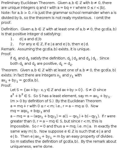

Hi skatenerd,
Whenever I have a problem that involves gcd, one of my first thoughts is the fact that there are integers x and y such that ax + by = gcd(a,b). So here's an alternate proof using this fact:
Let k = gcd(a,b). "Clearly" dk divides both da and db. Let x and y be integers with ax + by = k. Then dax + dby = dk. If e divides both da and db, then e divides dax + dby =dk. Thus gcd(da,db) = dk.
If you're interested, the attachment has more discussion about ax + by = gcd(a,b):
